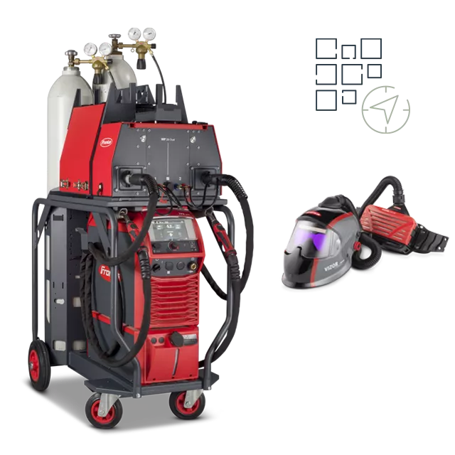

A MIG/MAG welding system for all applications
The TPS/i is one of the most advanced welding systems with a stunning level of performance that will satisfy the most demanding requirements. The intelligent welding system is suitable for both manual and automated use. Its modular design and easy expandability enable the TPS/i to be configured to suit individual requirements. In addition, its extensive communication features ensure significant efficiency gains and excellent welding results with unalloyed, low- or high-alloy steels and aluminum.
The TPS/i is available with gas or water cooling in the 270 A, 320 A, 400 A, 500 A and 600 A power categories.

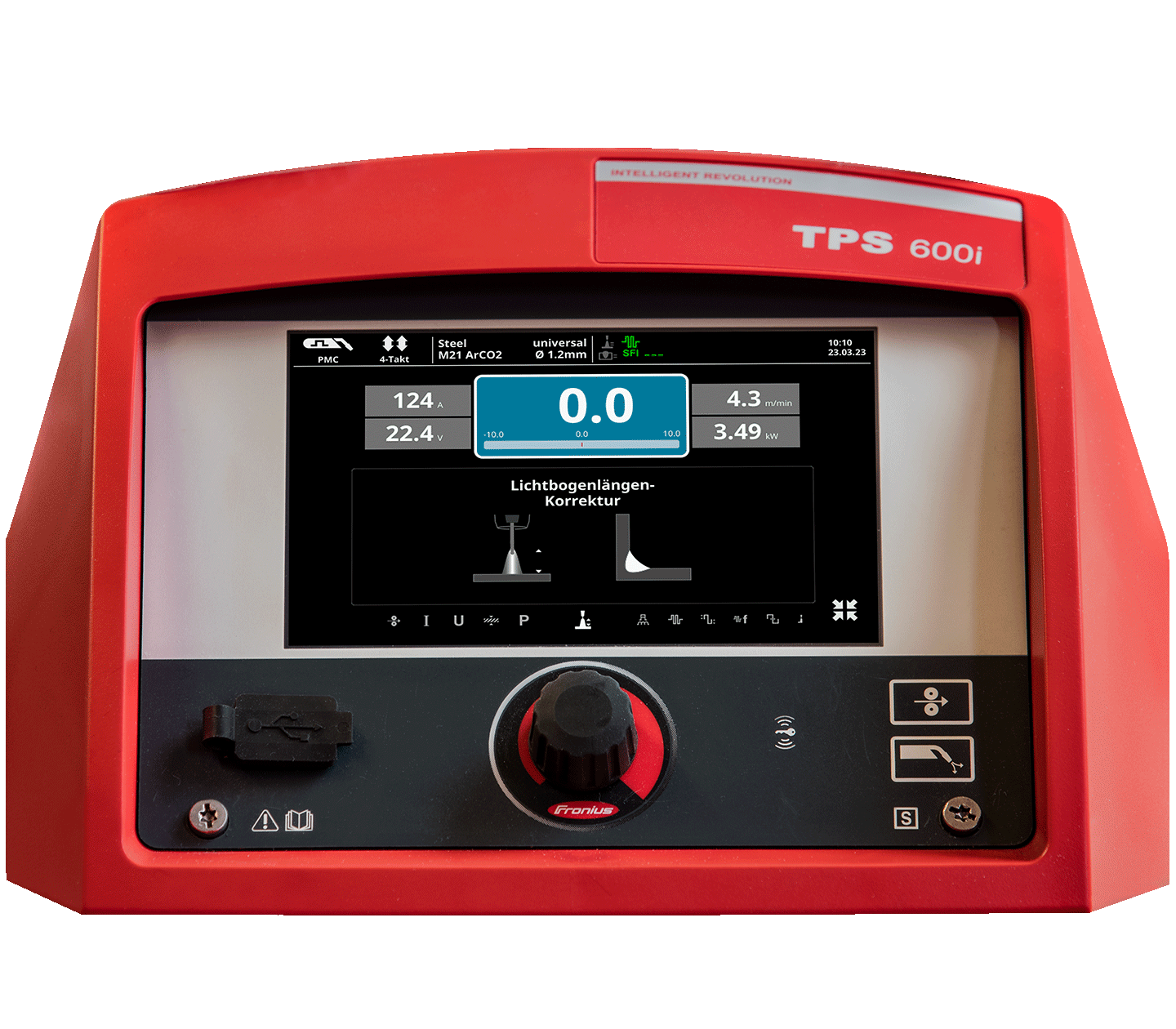

The innovative touch display enables all welding parameters to be set quickly and easily. The menu navigation is available in 32 languages and features an intuitive user interface. The TPS/i allows you to store up to 1000 jobs – i.e., the predefined welding parameters for the task in hand. These can be called up in a few simple steps and offer the option to access special welding task-related parameter assignments.
