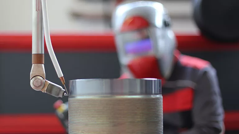

Slim welding torch – small internal diameter
The fully re-developed welding torch system allows you to weld significantly smaller inner component diameters.Send inquiry about SpeedClad 2.0
