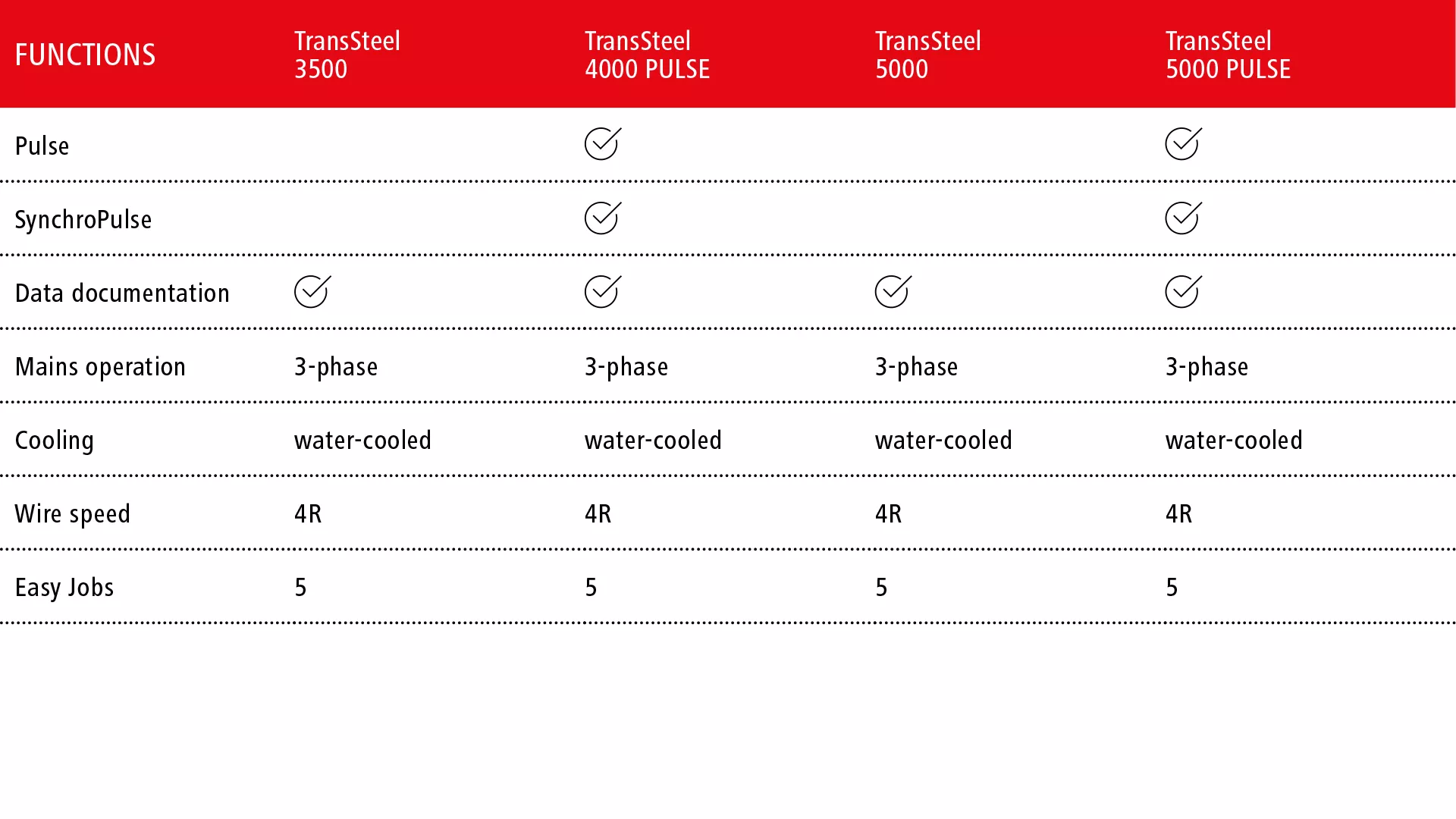

The MIG/MAG welding functions
Pulse
Welding controlled and fast
The new TransSteel 4000 Pulse and TransSteel 5000 Pulse mark the arrival of the pulsed arc in the TransSteel series. Controlled welding in the intermediate arc range together with optimum weldability when working with aluminum are now part of the basic package.
Special 4-step mode
for a more stable arc
The “Special 4-step mode” is particularly suitable for welding in the higher power range. In special 4-step mode, welding starts at a lower power, which makes the arc easier to stabilize.
SynchroPulse
Seam rippling for aluminum alloys
The “SynchroPulse” option is recommended for the welding of aluminum alloys when a rippled seam appearance is required. This effect is achieved by modifying the welding power between two operating points.
SynchroPulse works in Standard Synergic and Pulse Synergic mode – but only on the TransSteel 4000 and 5000 Pulse.
Spot and Stitch welding
with no material distortion
Spot mode enables you to place welding spots at regular intervals. As you have complete flexibility over the pause time between the intervals, spot welding is ideal for the tacking of workpieces. Stitch welding not only produces a rippled seam appearance, the low level of heat input reduces any possible material distortion when working with light gage sheets.
