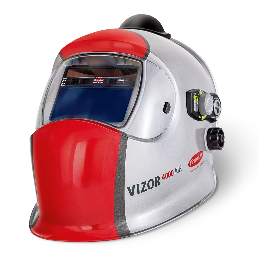

Protective clothing for welders
Spending an entire day at the welding table is stressful. The UV radiation and the welding fumes are just some of the factors that can be dangerous if you do not have the right protection. The correct welding equipment makes the crucial difference in this area.
