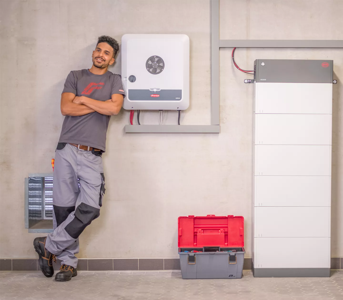

The combination of a Fronius inverter and a compatible storage system makes different backup power variants possible, from the basic backup power supply with the PV Point (with the GEN24 Plus) through to Full Backup. You can therefore offer your customers tailored solutions for increased independence.

Reserva – The Fronius Storage Solution
Use solar energy around the clock – with the Fronius Reserva. The high-voltage battery with DC coupling ensures highly efficient energy transfer. Thanks to its modular capacity ranging from 6.3 to 15.8 kWh, it adapts flexibly to customer needs. Perfectly matched to Fronius hybrid inverters, it integrates perfectly into PV systems. Customer data remains secure on European servers, while our proven service & support is always available to you.

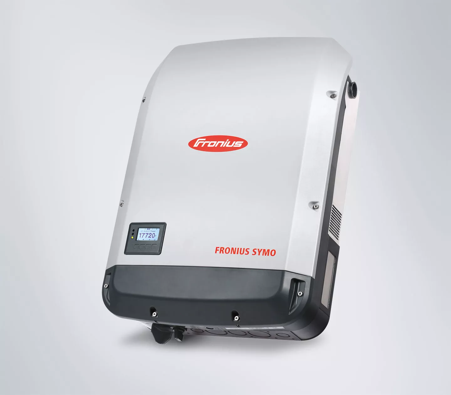

A combination with an AC-coupled storage system can be used for retrofitting a solar storage system for PV systems without a hybrid inverter. Fronius inverters are compatible with various AC-coupled storage systems, however visualisation in the Solar.web online monitoring tool is not possible with this solution.

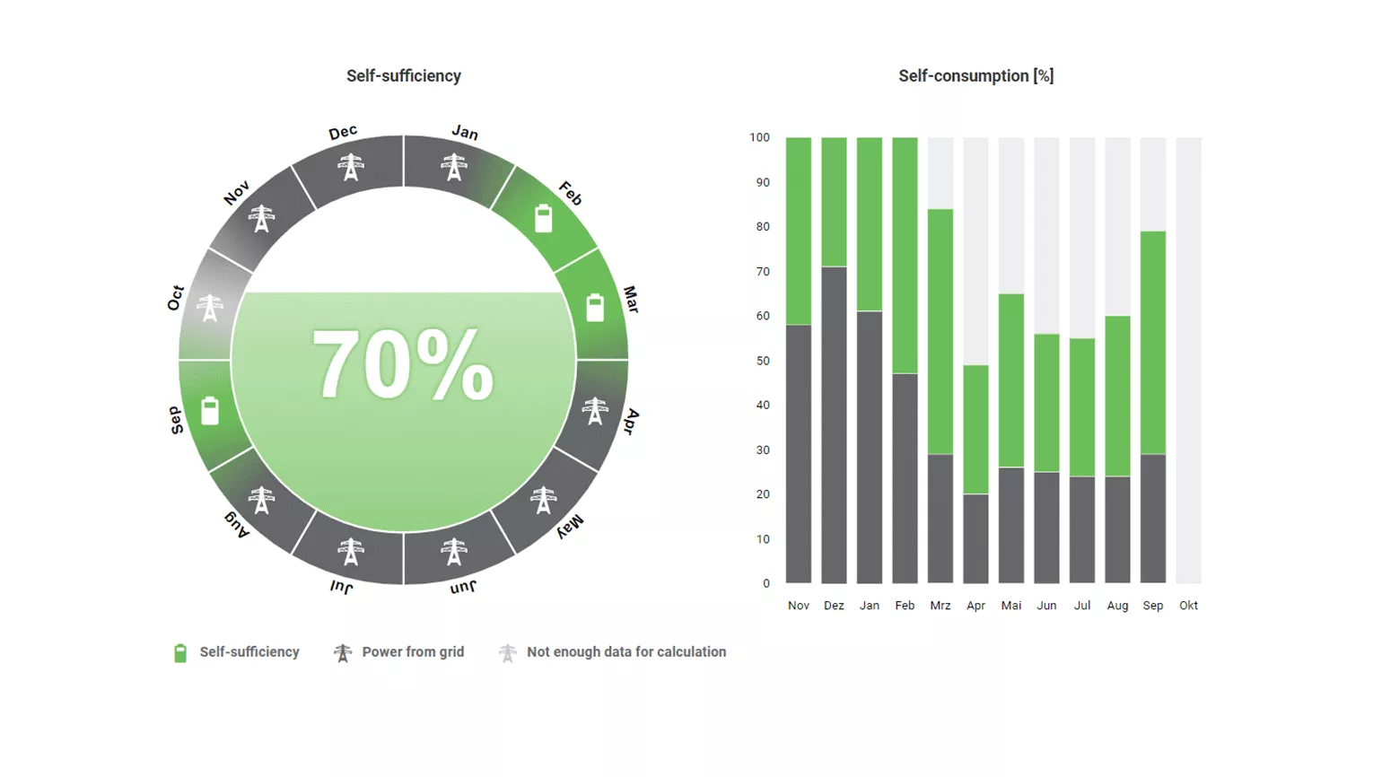

Simulate the potential of a storage system easily in Solar.web
You can illustrate the effects of a storage system on self-consumption and autonomy to your customers very easily in Solar.web. A simulation helps to quickly and easily demonstrate how the integration of a storage unit can optimise the PV system.
More about Solar.web
Summary
The level of sel-sufficiency increases from 40% to 70%. This increase of 30% corresponds to 1,086,643 kWh of energy that is used in your own househould instead of being fed into the grid.

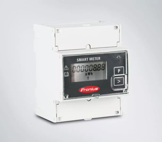

  • Fronius Smart Meter
    The smarter way to record your energy consumption!
