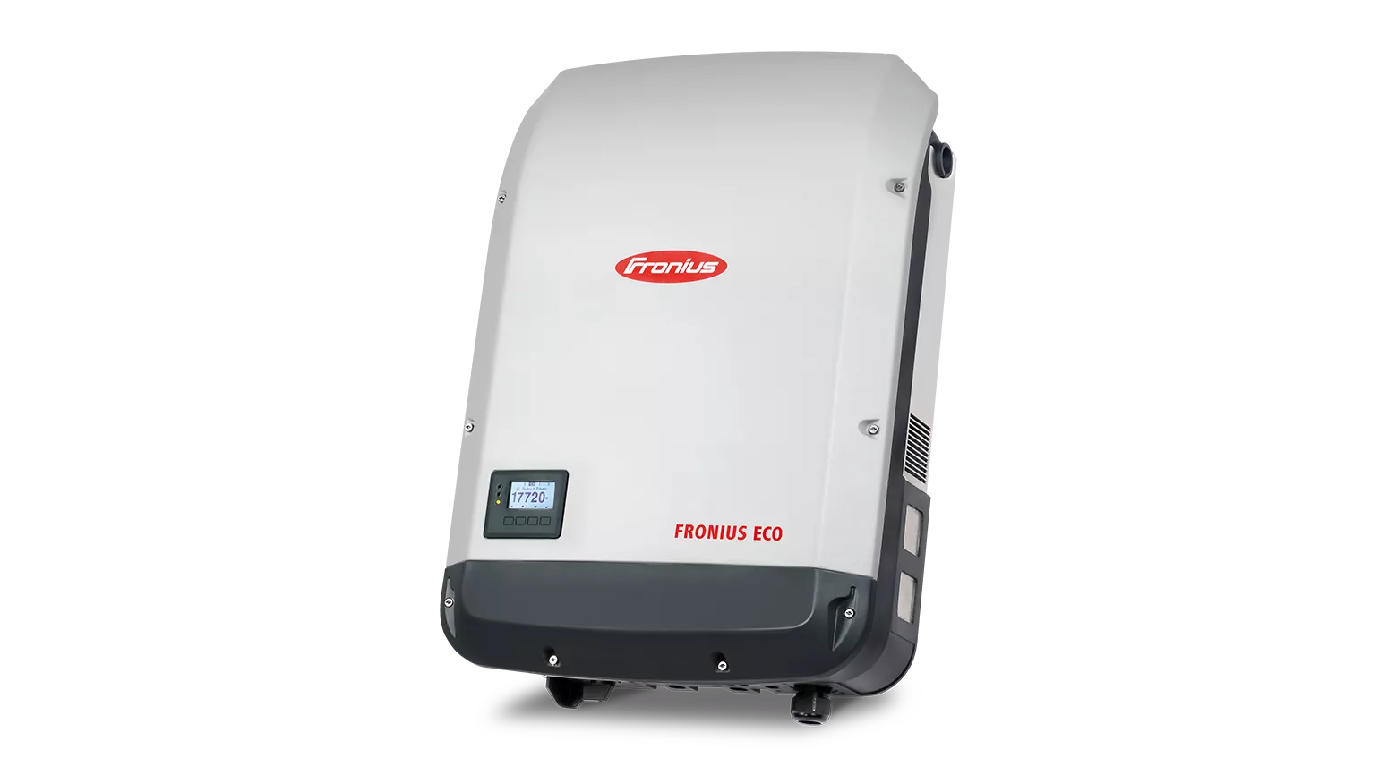

Fronius Eco
The compact project inverter for maximum yields.
The three-phase Fronius Eco in power categories 25.0 and 27.0 kW perfectly meets all the requirements of large-scale installations. Thanks to its light weight and SnapINverter mounting system, this transformerless device can be installed quickly and easily either indoors or outdoors. This inverter series sets new standards with its IP 66 protection class. In addition, its integrated all-pole string fuse holders and optional DC fuse mean that string collection boxes are no longer required.

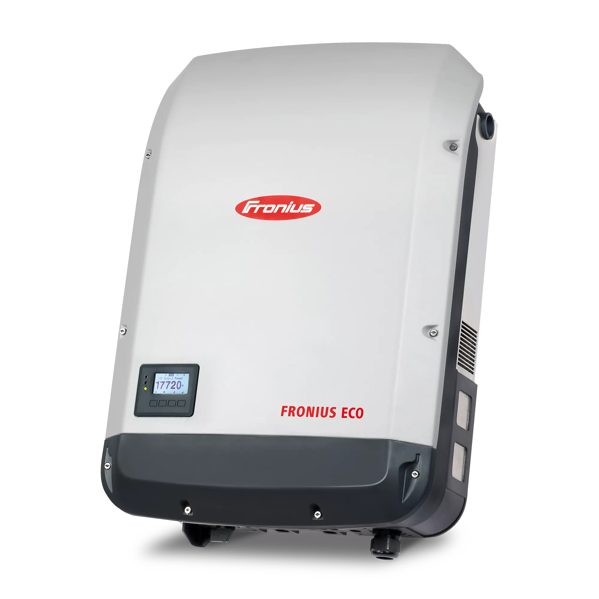

SnapINverter technology
The SnapINverter generation of inverters features a simple, standardised mounting system, making installation and maintenance easier than ever. A special feature in the design of the device is that the connection area is separate from the power stage set compartment, with both being installed separately. The remarkably light connection area and all its cabling is fitted to the wall first, followed by the power stage set. The innovative hinged system makes installation and servicing extremely user-friendly. The inverter is simply placed in the wall bracket and then secured. This means that it is not necessary to remove the entire inverter for servicing, just the power stage set. All the cabling remains in place.
