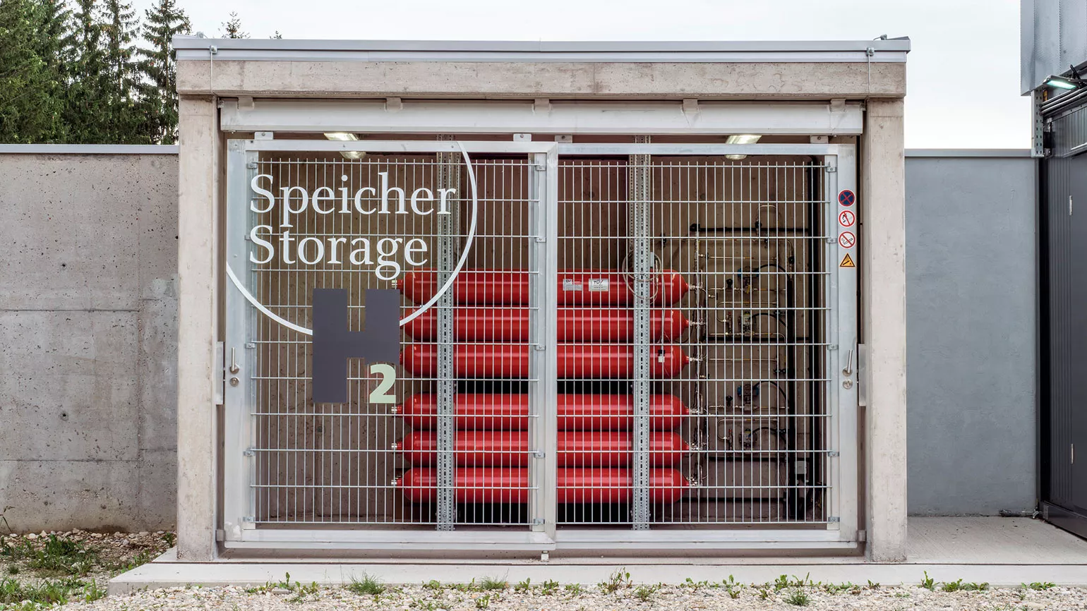

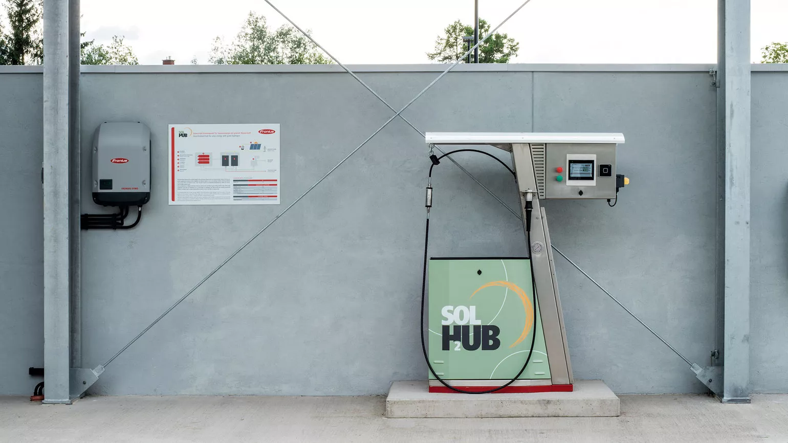

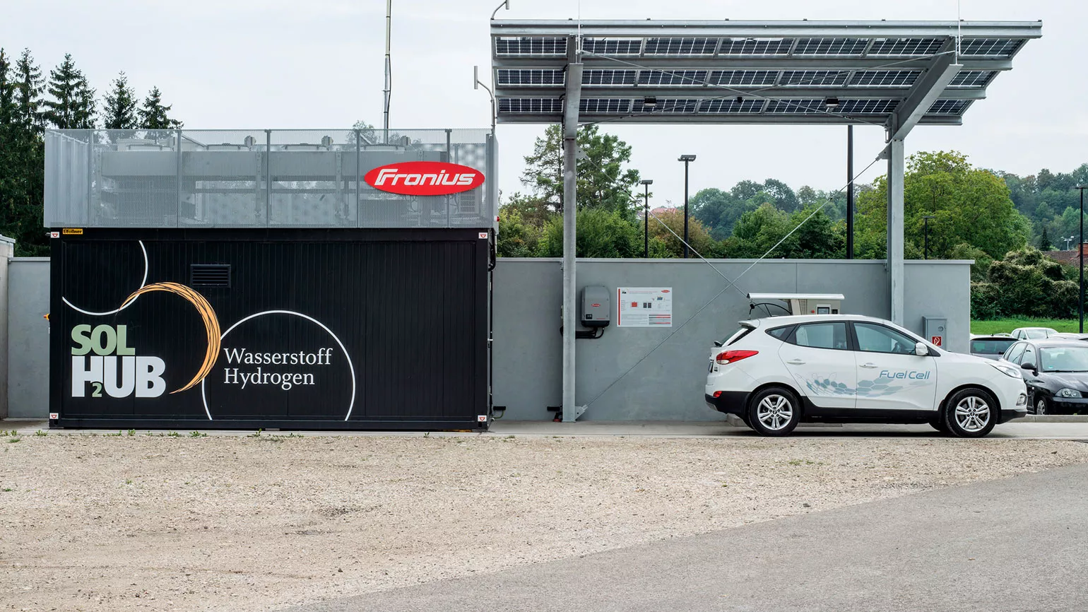

One pilot project is already being implemented – an inhouse refuelling station for commercial and municipal vehicles at the Thalheim site in Austria. Green hydrogenis generated from PV energy using a high-pressure electrolyser, which can then be used to refuel vehicles or be temporarily stored in steel cylinders. The system also offers the possibility of reconverting the stored H2 back into electricity using a fuel cell.
