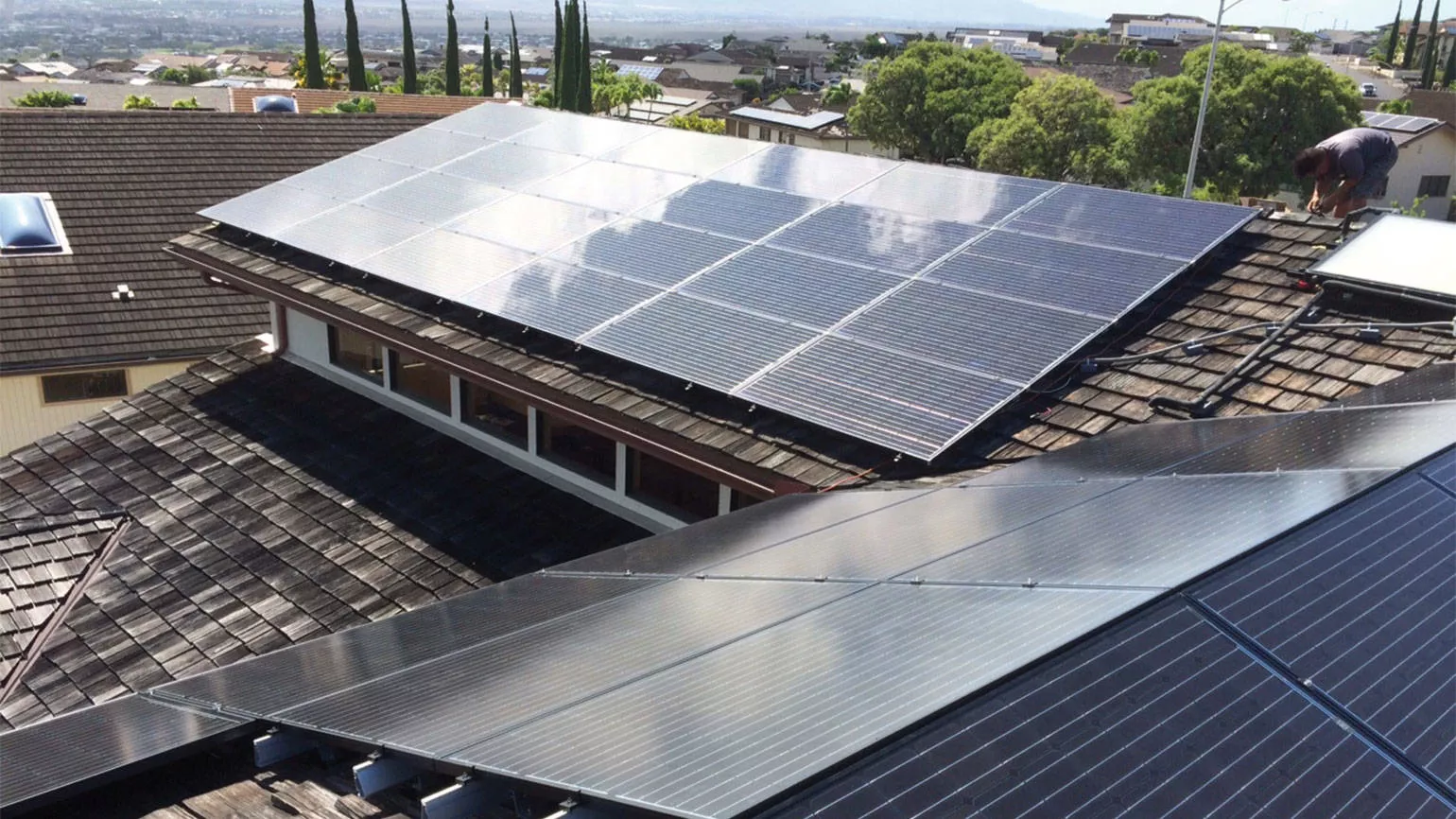

Residential system of Danilo and Echy Lopez created by SunKing, Inc.
Details
Size of installation 10.04 kW
Purpose, system type
Residence
Module type and area
Left Fronius Primo 3.8 has 14 modules,1 String of 4 SolarWorld 280 Mono
facing East on MPPT 1, and 1 String of 10 SolarWorld 280 Mono facing West on MPPT 2
Right Fronius Primo 6.0 has 24 modules, 1 String of 12 SolarWorld 255 Mono
facing South on MPPT 1 and 1 String of 12 SolarWorld 255 Mono facing South on MPPT 2
