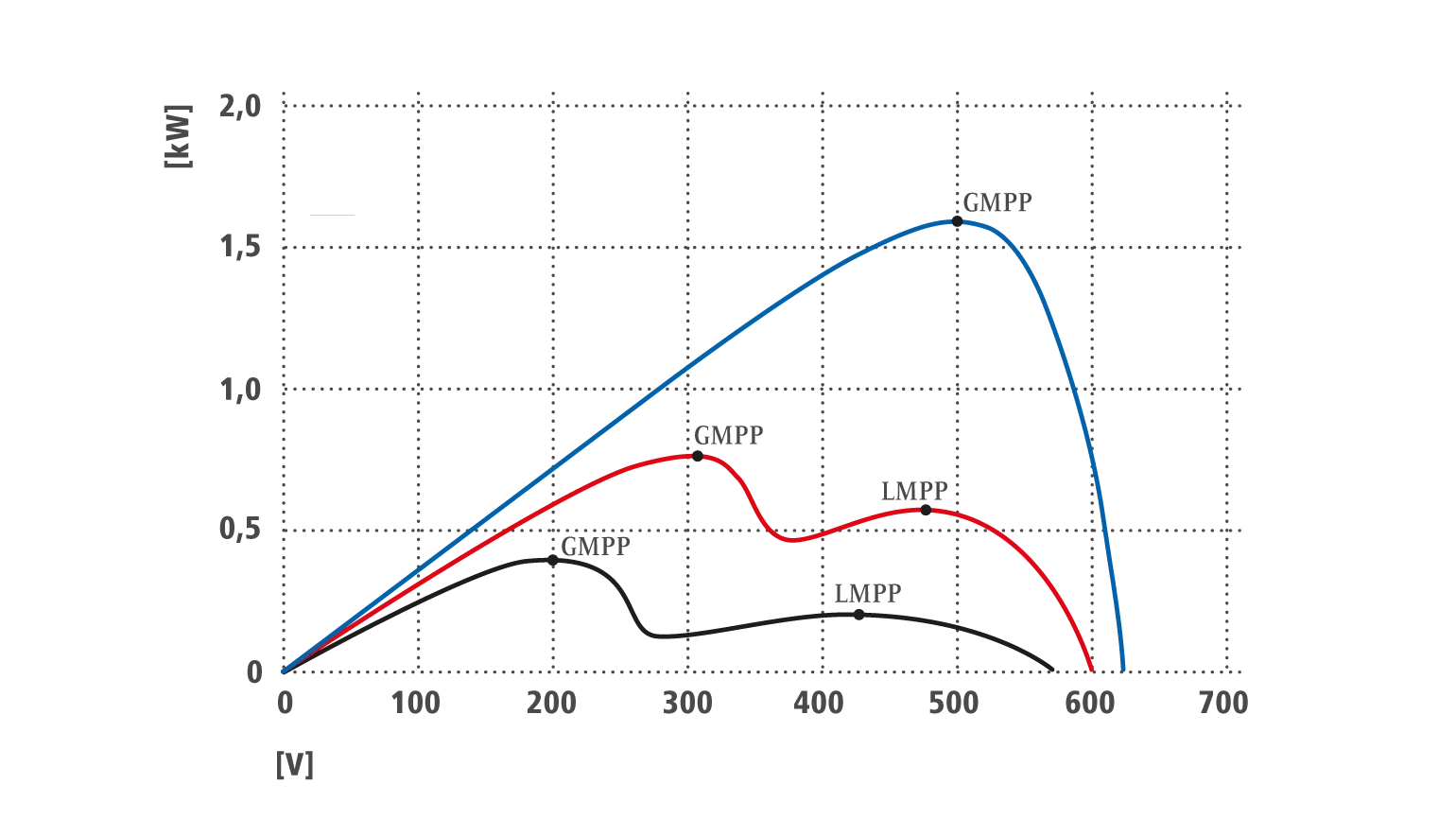

How the Dynamic Peak Manager works
The Dynamic Peak Manager is a highly efficient shade-tolerant algorithm, which analyses the entire P-U characteristic curve at regular intervals.
This means that the Dynamic Peak Manager always finds the global Maximum Power Point (GMPP).

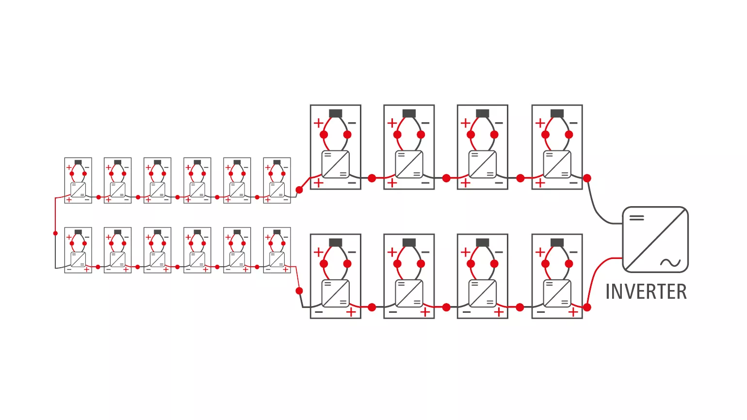

Power optimisers in the case of shading of PV systems
DC power optimisers adjust the voltage of shaded PV modules by boosting or decreasing it. The component requires energy to do this.
The more shade there is, the higher the consumption of the optimiser, and the lower the efficiency. This means, especially in partial shading situations, that power optimisers often cannot compensate for the shade, so they do not generate a higher yield.
Another disadvantage of DC-optimised systems is the large number of components on the roof.
Each power optimiser sits directly behind the PV module on the roof and is therefore continuously exposed to heat, cold, rain and snow. This is bad for the sensitive power electronics and can have repercussions for servicing and the fire risk.
The number of defects in DC plug connections, which represent the main source of photovoltaic system problems, is tripled in DC-optimised systems.
Conclusion:
Using DC power optimisers provides no added economic value. Instead, the risk of system failure increases, which results in additional costs due to greater service requirements.
1 / 2
System with string inverters – 21 plug connections
System with DC optimisers – 61 plug connections

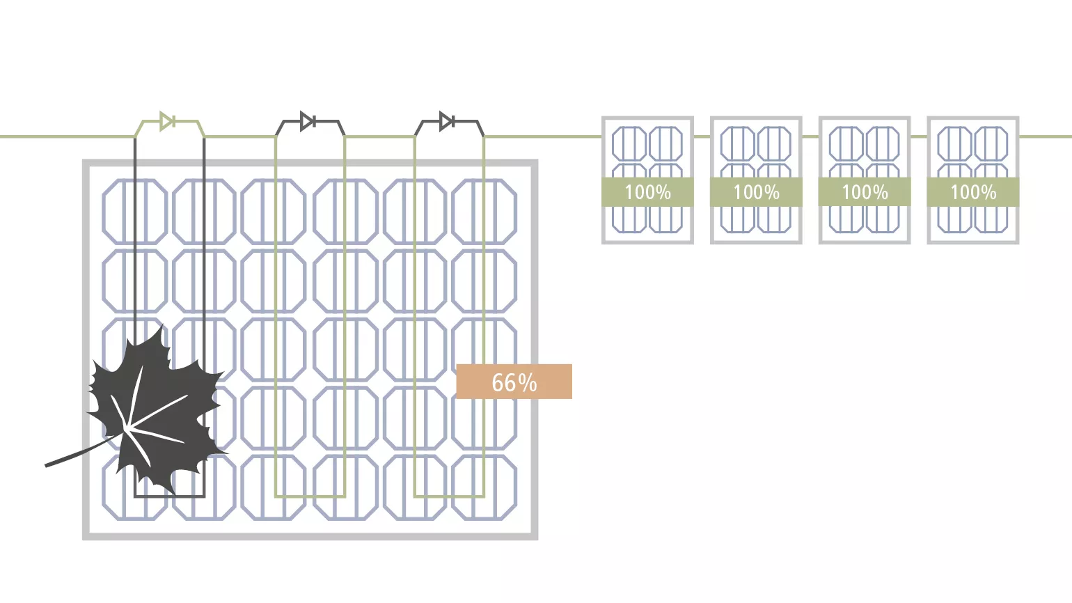

Bypass diodes prevent losses in the case of PV shading
Over the years, the false belief that a shaded PV module also limits the power of all other PV modules in the same string has become established in many peoples’ minds.
But the cells in PV modules are usually combined with three so-called bypass diodes. If the PV module is in shadow, the diode becomes conductive and the affected part of the module is bypassed. The other PV modules, however, continue to perform at full power.
This ensures that a shaded PV module does not affect the power of the other PV modules in the same string.
