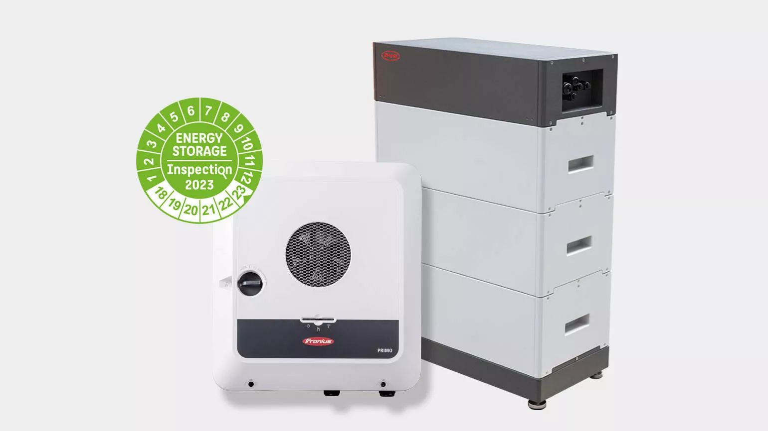

Storage inspection: First place
Thanks to Multi Flow Technology, first place was achieved in the Energy Storage Inspection organised by HTW Berlin University, with a sensational overall efficiency of 94%.
The GEN24 Plus in combination with the BYD storage unit achieved the highest values in all four energy conversion paths (PV feed-in, PV battery charging, AC battery charging, AC battery discharging) tested during the inspection. Find out more about the study here.
