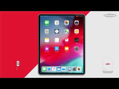

General notes and information for Fronius Snapinverter.
  1. On the inverter display, navigate to “Setup” --> “Wifi Access Point” and confirm the activation.
  2. Connect your laptop / tablet / smartphone to the WLAN network “fronius_2xx.xxxx” that is now available. Once the WLAN access point has been activated, the network security key will appear on the inverter display.
  3. Enter the following IP address in the address bar of your browser (e.g. Google Chrome): “192.168.250.181”.
  1. Set the IP switch on the Data- or Hybridmanager of the SnapINverter to position A (small DIP switch by the 4 LEDs).
  2. Connect your PC / laptop to the SnapINverter (Data- or Hybridmanager) using a network cable (CAT5 or higher).
  3. Enter the following IP address in the address bar of your browser (e.g. Google Chrome): “169.254.0.180”.
