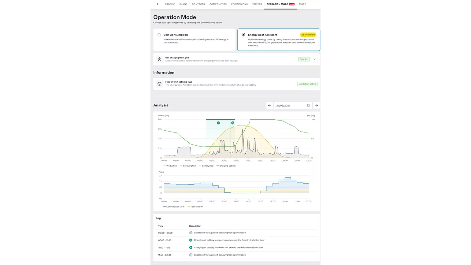

Energy Cost Assistant
Your system must satisfy the following requirements to use the Energy Cost Assistant:
  • Compatible inverters: GEN24 Plus or Verto Plus (also via a GEN24 or Verto upgrade using Fronius UP.storage; Fronius Symo Hybrid is not supported)
  • Compatible battery: Fronius Reserva, Reserva Pro, or compatible batteries from BYD or LG
  • Fronius Solar.web Premium
  • Latest inverter firmware (version 1.34.6 or higher)
  • Weather forecast enabled
Additionally, one of the following conditions must be met to allow the Energy Cost Assistant to perform optimizations:
  • Dynamic electricity tariff (e.g., spot market rate or time-dependent tariff)
  • System feed-in limit
The Energy Cost Assistant can be enabled, controlled, or disabled under the system settings in the Solar.web portal (go to the “Operating mode” area under “Settings”).
You can also see how the Energy Cost Assistant manages the battery in real time and throughout the day, including forecasts, rates, and feed-in limits.
The status of the Energy Cost Assistant is displayed on the app dashboard, a feature which you can enable or disable under Settings → System information → Operating mode.
You will only be able to access the settings and view the status on the dashboard if you have system owner or maintenance permissions.
Screenshot operation mode
The Energy Cost Assistant only charges the battery from the grid when it makes economic sense to do so. As part of its calculations, the ECA considers that every charging cycle puts a strain on the battery and therefore results in indirect costs. The ECA will only allow charging from the grid if:
  • There is insufficient energy available to cover the expected load
  • The electricity price is so low that charging is worthwhile despite the extra battery wear
  • The system’s behavior is also influenced by the selected operating mode:
  • Maximum savings: the battery is charged from the grid more frequently to keep energy costs as low as possible
  • Balance: the battery is charged only if the price differential is great enough to justify it.
Detailed information about how the Energy Cost Assistant works is available on the web portal. Information in the “Operating mode” area under “Settings” shows how the Energy Cost Assistant is managing the battery right now and over the course of the day. This information includes aspects such as:
  • Scheduled charging and discharging processes
  • Underlying generation and consumption forecasts
  • Electricity tariffs used
  • Detected feed-in limits
A graphical representation helps to clearly understand the charging and discharging activity.
The app shows whether the Energy Cost Assistant is currently active. Detailed information about the logic underlying how the ECA operates is available on the web portal.
Once enabled, the Energy Cost Assistant will first need some time to analyze the system and generate forecasts.
During this phase, optimizations are limited or not performed at all. It may therefore appear that the Energy Cost Assistant is doing nothing. As soon as sufficient data is available, the Energy Cost Assistant will automatically start to optimize your processes.
