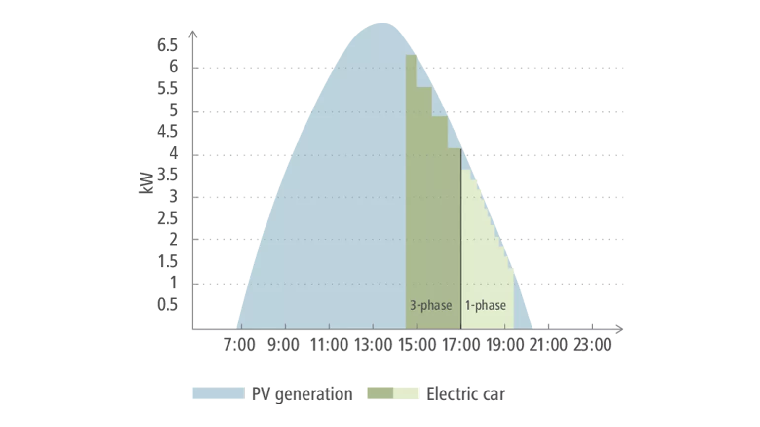

A starting power level and 3-phase power level can be defined for dynamic PV surplus charging.
The starting power level specifies the surplus amount that the photovoltaic system needs to reach before the Wattpilot begins charging the car.
The 3-phase power level is the surplus value that needs to be reached by the photovoltaic system to switch from1-phase to 3-phase charging. The figure shows the example of a starting power level of 1.38 kW and a 3-phase power level of 4.14 kW. If the PV surplus is between 1.38 and 4.14 kW, the Wattpilot regulates the charging power in 230 Watt steps. If the PV surplus exceeds 4.14 kW, the Wattpilot will switch from 1-phase charging to 3-phase charging in 690 Watt steps.
