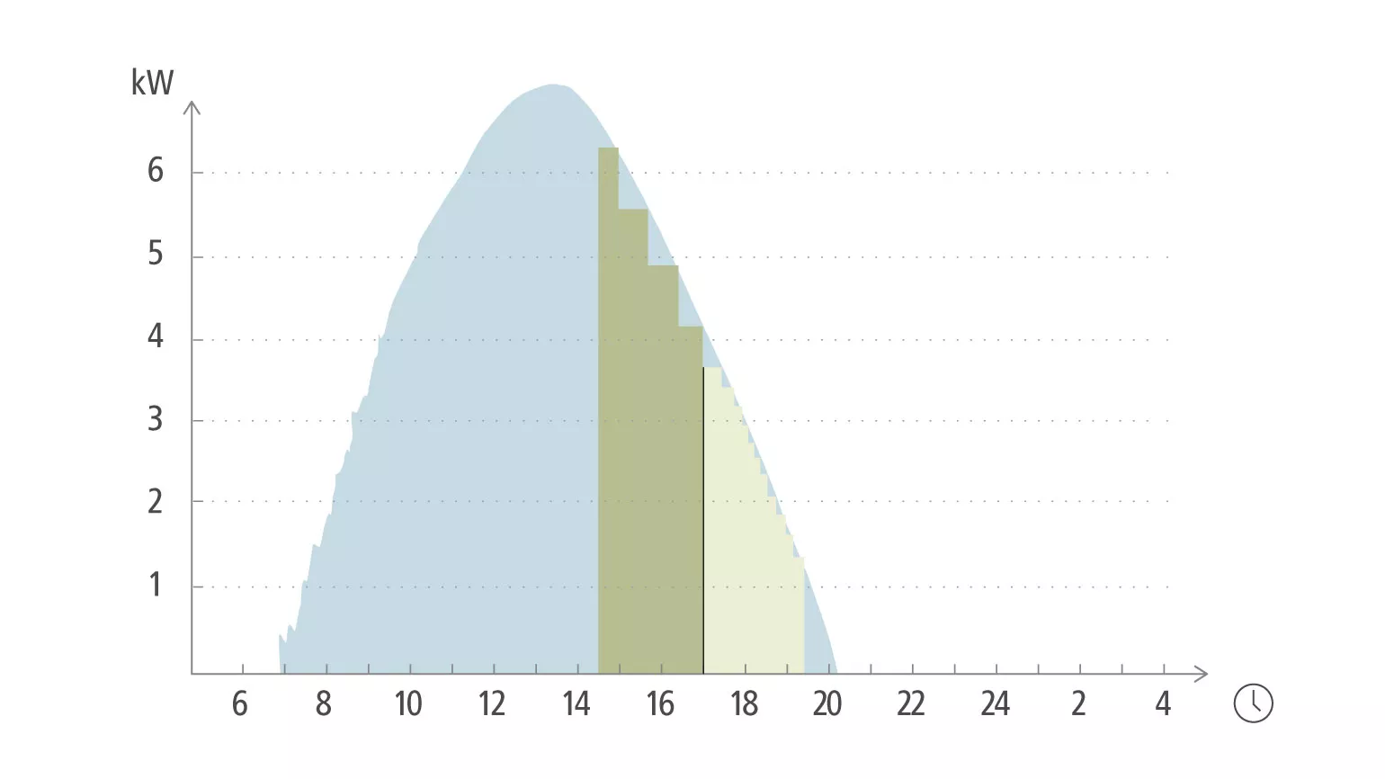

• PV surplus • Electric car
Dynamic Load Balancing for optimal power distribution
With Dynamic Load Balancing, the amount of self-generated solar power available from your customer’s own photovoltaic system as well as the maximum household load connected to the grid is optimally used: your customers can charge up to three electric cars at the same time and in an energy-optimised manner with one system. The energy produced by the photovoltaic system as well as the household consumption are taken into account. This not only saves high connection costs, but also effectively avoids load peaks. The energy required can be precisely controlled and therefore is dynamically distributed among the vehicles being charged.

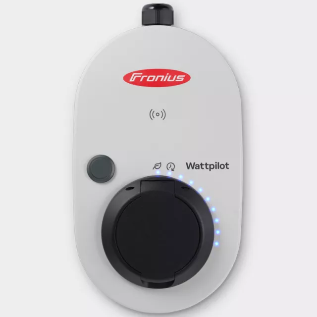

The Fronius Wattpilot
The electric car charger for at home and on the road. Useful functions and features for your customers.
