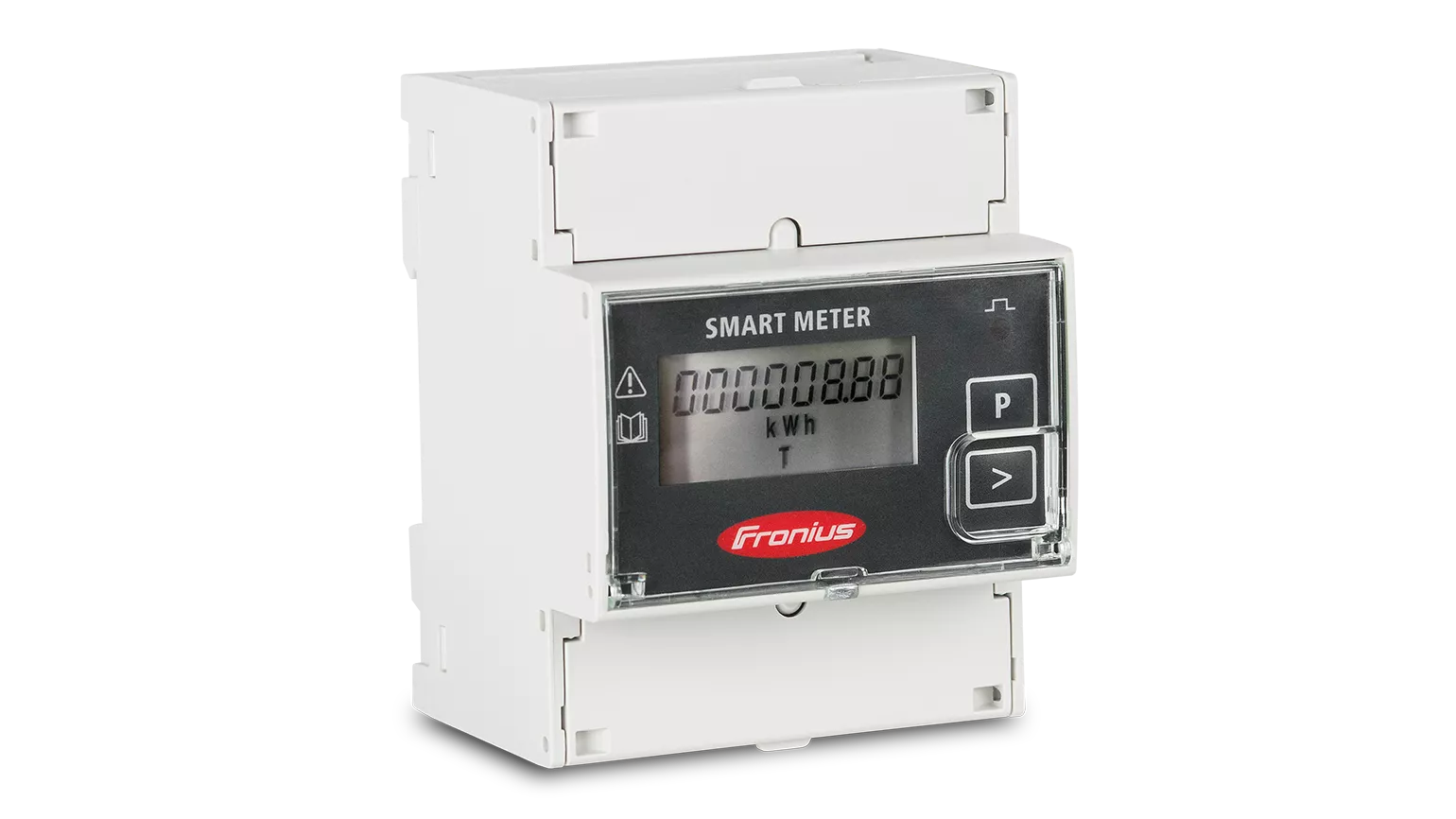

Technical Data
General Data
Weight | 0,35 kg |
Nominal voltage | 400 - 415 V |
Max. current | 3 x 50 000 A |
Connection cross-section phase and neutral conductor | 0,05 - 4 mm² |
Connection cross-section current transformers and communication cables | 0,05 - 4 mm² |
Self-consumption | 2,5 W |
Starting current | 40 mA |
Accuracy class | 1 |
Active energy accuracy | Class B (EN50470) |
Reactive energy accuracy | Class 2 (EN/IEC 62053-23) |
Overload (short-term) | 20xImax/0,5 s |
Weight | 0,35 kg |
Installation | Indoor installation (DIN rail) |
Housing | 4 modules DIN 43880 |
Degree of protection | IP 51 (front panel) / IP 20 (terminals) |
Display | 8-digit LCD |
Operating range | -5 - +55°C |
Interface to inverter | Modbus RTU (RS485) |
