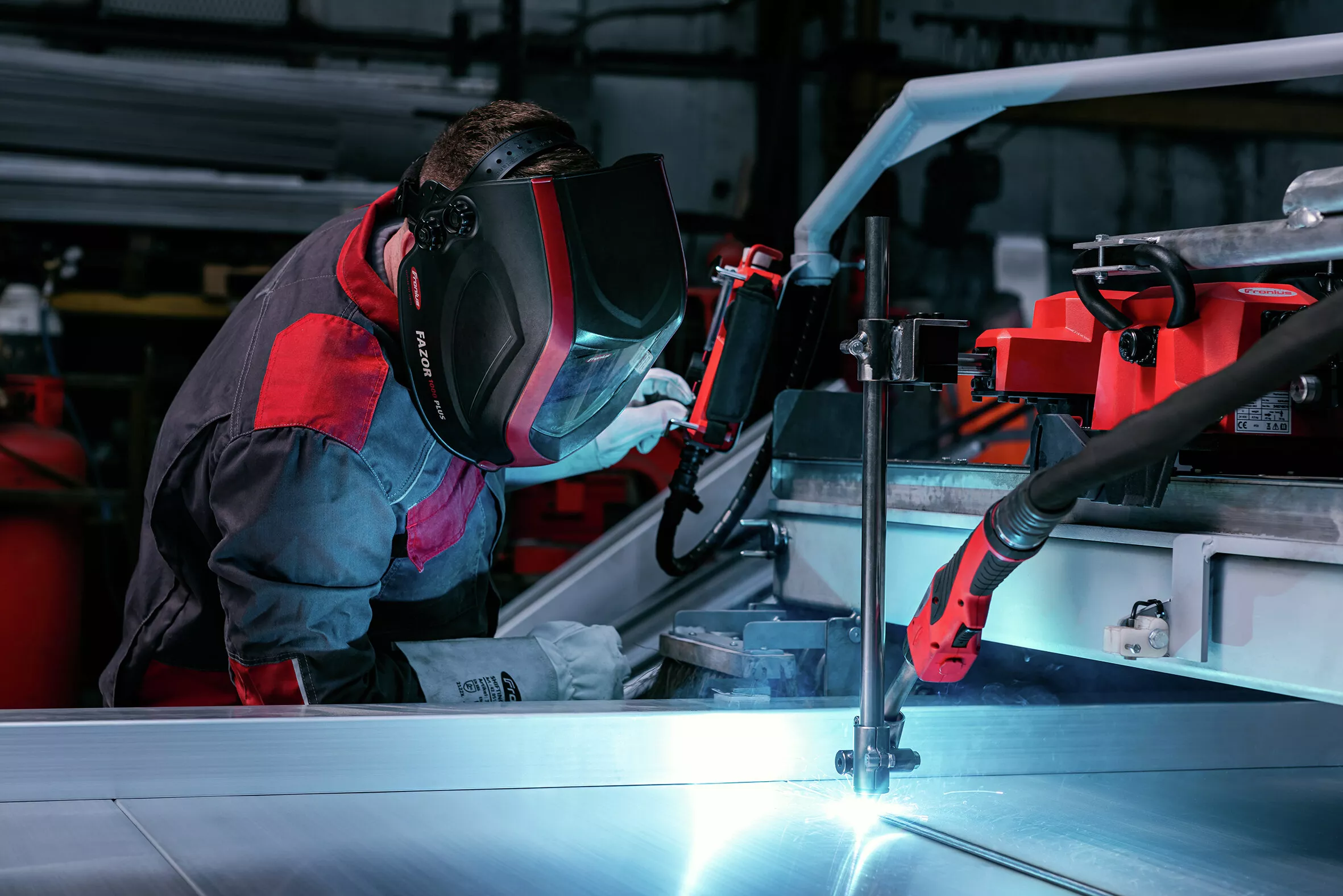

Every Fruehauf trailer contains numerous welded joints, many located in load‑bearing areas exposed to shock, vibration and torsion.The challenge is intensified when welding aluminium bodies, where controlling heat input is critical to avoid distortion, porosity and defects - particularly when joining thick structural components to thin sidewall panels. Fruehauf needed a solution that could deliver repeatable weld quality, support long weld seams and maintain productivity without compromising structural integrity or appearance.

Fruehauf addressed these challenges with Fronius TPS 400i welding systems, using Pulse welding and intelligent arc control functions to precisely manage heat input and ensure stable, high‑quality welds in aluminium and steel. The addition of JobMaster Push‑Pull torches improved wire feed reliability over long body lengths, while the FlexTrack 45 Pro welding carriage introduced semi‑automation for longitudinal seams, delivering consistent travel speed, reduced operator fatigue and significant time savings. Together, these technologies have improved efficiency, repeatability and weld quality, supporting Fruehauf’s commitment to reliable, UK‑built trailers.

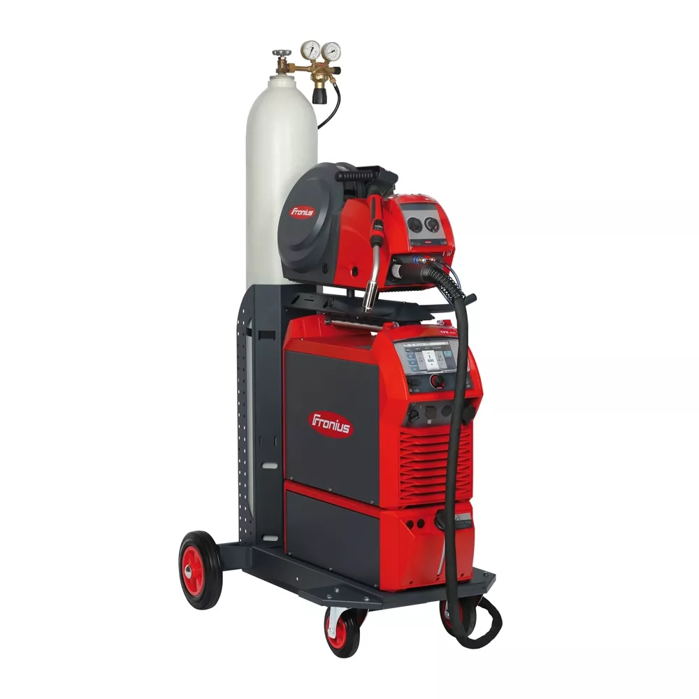

Fronius TPS/i welding machine
TPS/i
  • Water or gas-cooled versions available
  • Easy operation via button or touchscreen – even when wearing gloves
  • Can be upgraded at any time. Standard, Pulse, LSC PMC, CMT: the perfect Welding Package to suit any application

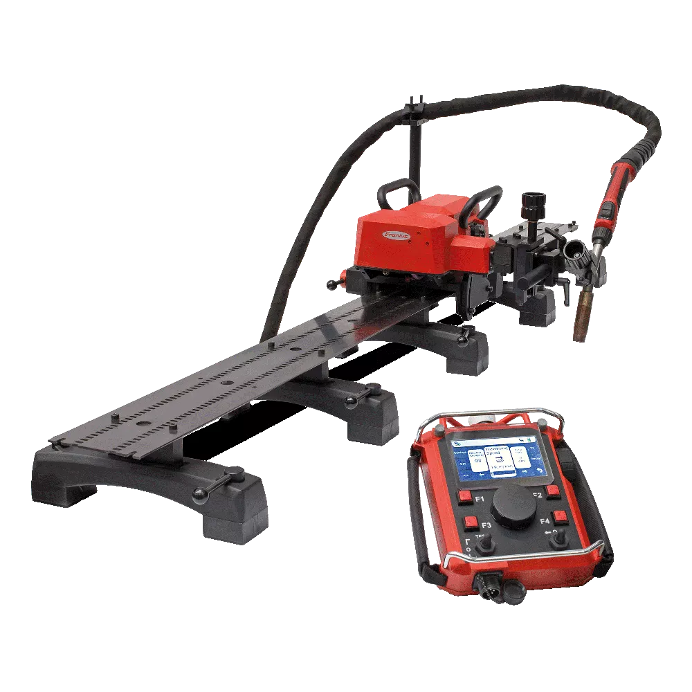

FlexTrack
  • Flexibility for longitudinal seam and orbital applications
  • Precise movements and constant welding speed for perfect reproducibility of welding results
  • Quick and easy set-up of rails and carriage
