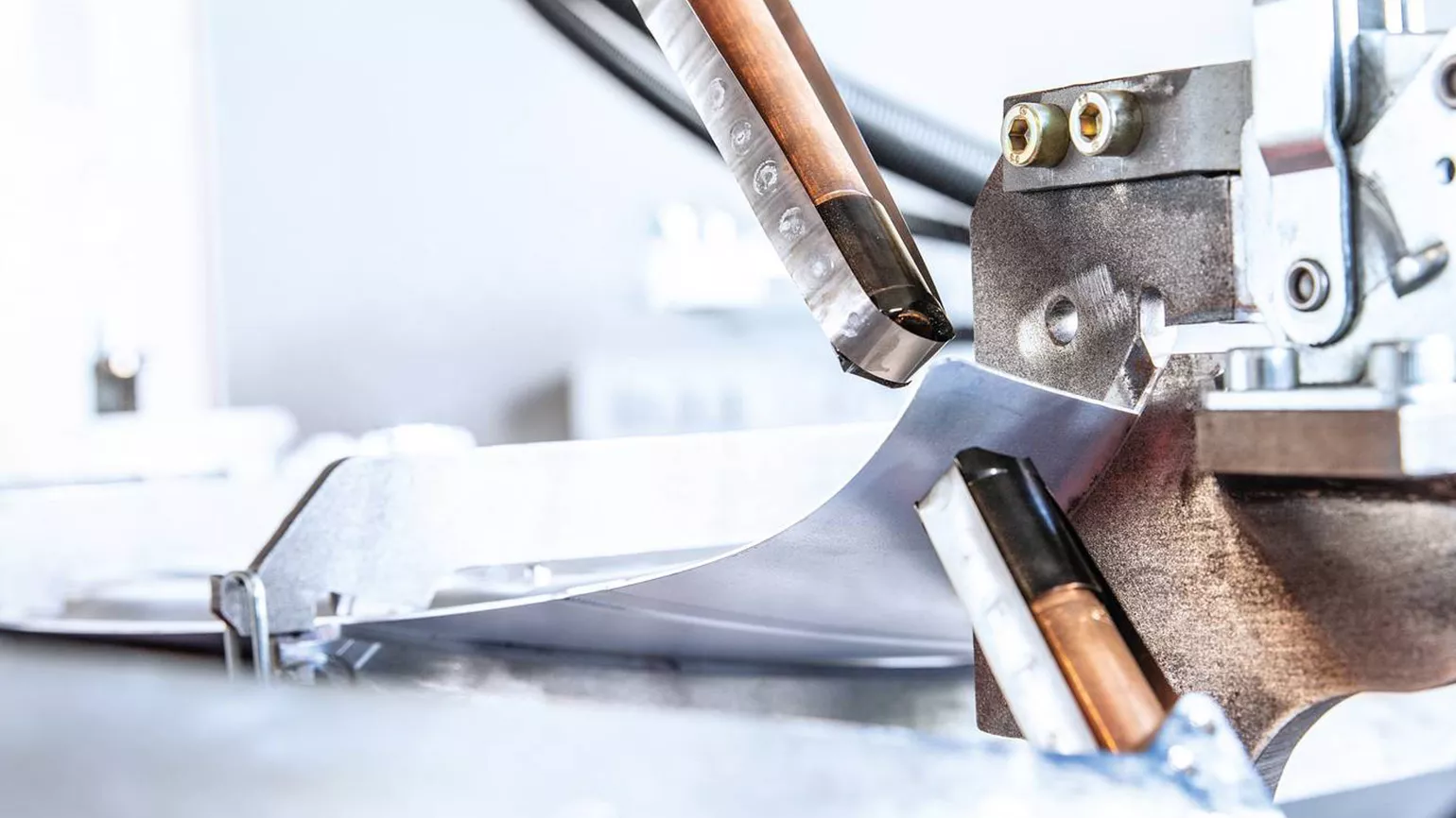

Efficient Spot Welding with DeltaSpot
Resistance Spot Welding Without Cap Milling
DeltaSpot is an innovative resistance spot welding process for aluminum, steel and other materials. Its most distinctive feature is the revolving process tape, which is located between the electrodes and the sheets to be joined. The constant movement of the tape results in a continuous welding process of consistently high quality.
With DeltaSpot, welding results are precise and 100% reproducible. The process tape transfers the welding current and protects the electrodes’ contact surfaces against contamination by aluminum, zinc or organic residues. This means that there is no need for laborious cap milling on the electrodes.
