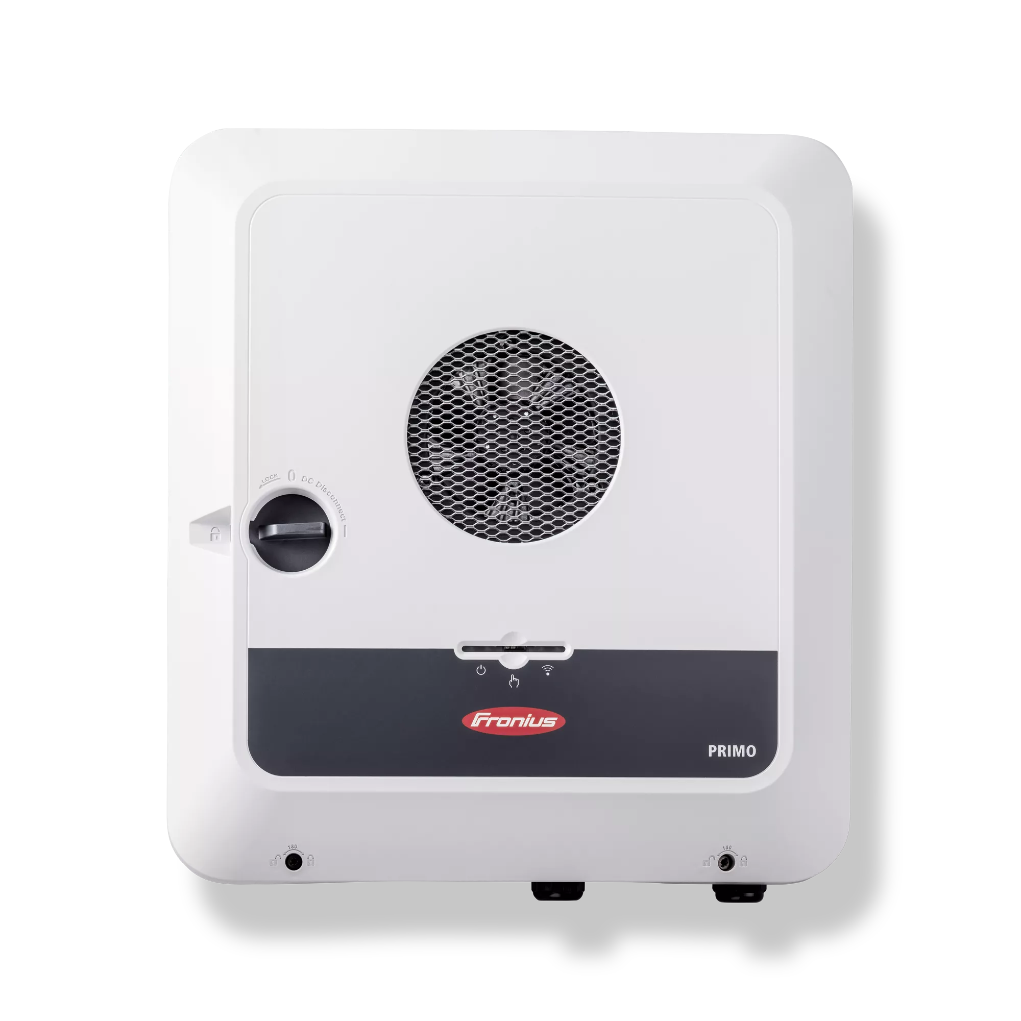

Fronius Primo GEN24
Inverters for private photovoltaic systems with integrated basic backup power function
Our single-phase Fronius GEN24 inverter is the heart of private photovoltaic systems.
The Fronius GEN24 is equipped with PV Point, an integrated basic backup power function that supplies backup power to connected devices via a protected socket (as long as the sun is shining).
