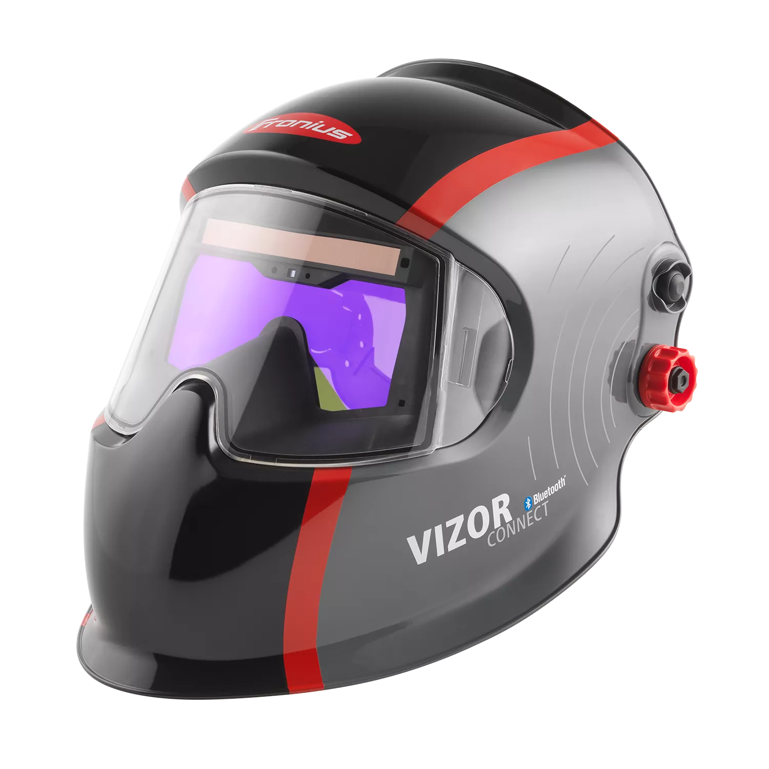

Interference from external light, welding light reflections, welding in inaccessible positions – there are many factors that can significantly impair the reliability of fully automatic protective welding helmets. Throughout 6 – 8 hours a day of welding, a welder will ignite the arc more than a hundred times. Every time it is ignited, there is a split-second delay before the automatic auto-darkening filter cartridge closes. Not so with the Vizor Connect.
Product details
Shade level range2,5/7-12 (man,) bzw, 2,5/5-12 (auto)
Switchover time / darken0,09 ms
Switching time dark / light0,1s-2,0sec
Cartridge size [LxBxH]58x125mm "
GENERAL DATA
Weight0,55 kg

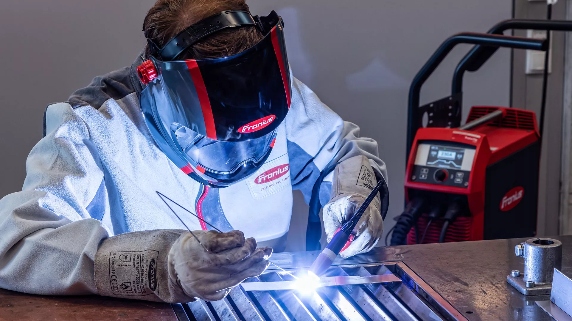

Bluetooth® Low Energy technology enables the welding helmet to be darkened by the welding system before the arc is even ignited. The auto-darkening filter cartridge remains reliably darkened even at extremely low currents and during out-of-position welding.
Autopilot
The autopilot automatically adjusts the level of protection. The auto-darkening filter cartridge darkens automatically and regulates the level of protection according to the arc intensity.
Panoramic view
The specially designed shape of the auto-darkening filter cartridge (nose cut) gives the wearer six times the field of vision of conventional welding helmets.
Brightness level of 2.5
With a brightness level of 2.5 when open, the Vizor Connect is ideal for both pre-fabrication and rework tasks, since the welder no longer needs to continually take the helmet on and off.
All the advantages of a conventional welding helmet
As well as using the Bluetooth® connection, the Vizor Connect can also be used with all conventional arc welding systems. The helmet features all the usual functions of a high-quality automatic welding helmet and as such responds to optical pulses (sensor mode) when the Bluetooth® function is turned off. The auto-darkening filter cartridge closes as soon as the arc ignites.

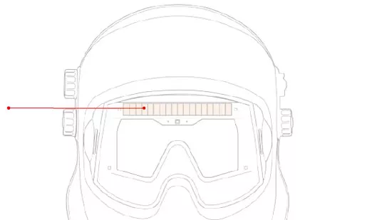

Lithium polymer battery that can be charged via USB-C cable, supported by solar cells

The auto-darkening filter cartridge on the Vizor Connect has a combined power supply consisting of solar cells and a rechargeable lithium polymer battery.
When the helmet is operated in Bluetooth® mode, the solar cells do not provide sufficient power. The helmet battery must therefore be charged.
  • Runtime in Bluetooth® mode: approx. 40 hours
  • Charging time: approx. 3 hours
