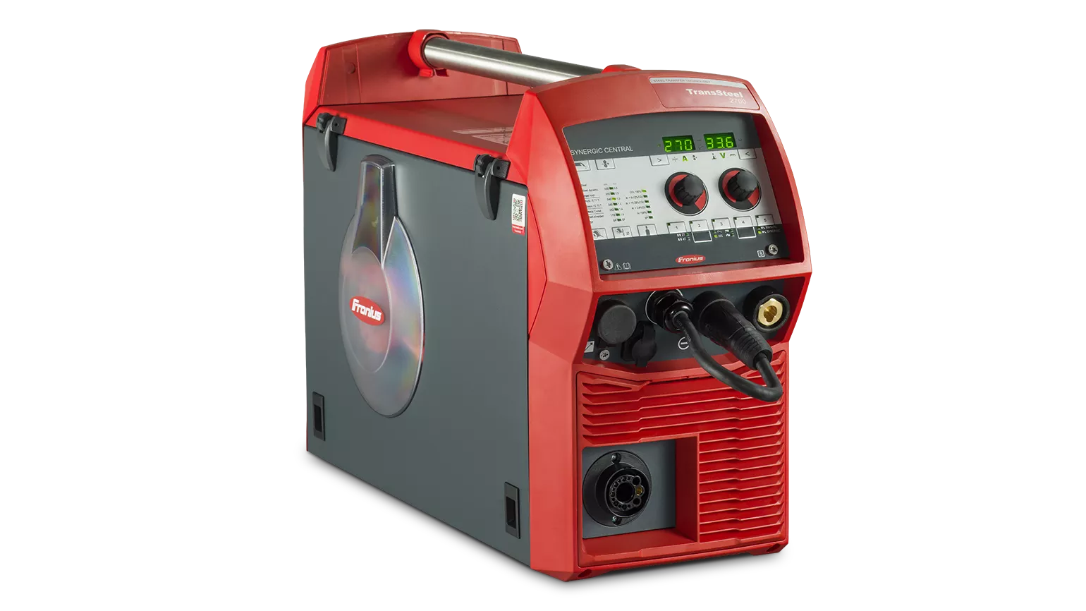

TransSteel Compact
No matter what the welding task - MIG/MAG, TIG and electrode welding with just one device.
Whether a construction site or a workshop, from agricultural enterprises to metalworking companies – for assembly, repair, and maintenance work, the TransSteel Multiprocess series masters the MIG/MAG, TIG, and electrode welding processes to professional levels.
Like all Multiprocess welding systems from Fronius, the TransSteel 2700 is ready for use in just three steps: select the wire, wire diameter and gas and start welding. You can switch between the individual welding processes in 60 seconds. In addition, the TransSteel can be used as a single-phase device up to 220A (TIG).
