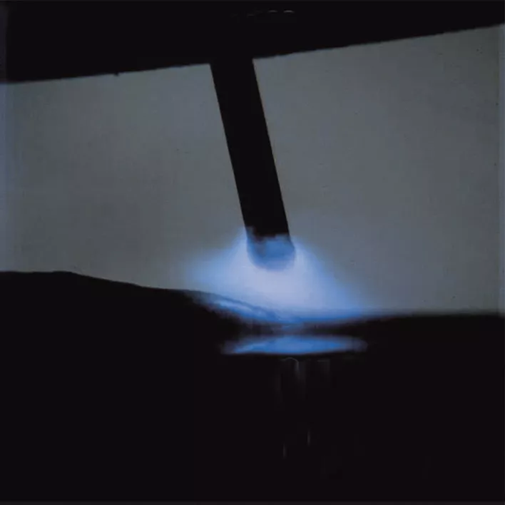

    During welding, the wire moves forward and is pulled back again as soon as the short circuit occurs. As a result, the arc only introduces any heat for a very brief period during the arc-burning phase. The result is spatter-free material transfer. The arc remains stable, regardless of the surface characteristics of the workpiece or how quickly the welding specialist works. This means that CMT can be used anywhere and in any position.
    CMT Cycle Time
    CMT process visualization
    Welding does not inevitably have to mean welding spatter and rework. CMT promotes controlled droplet detachment during the short circuit, while the current is kept low. The result is virtually spatter-free material transfer.
