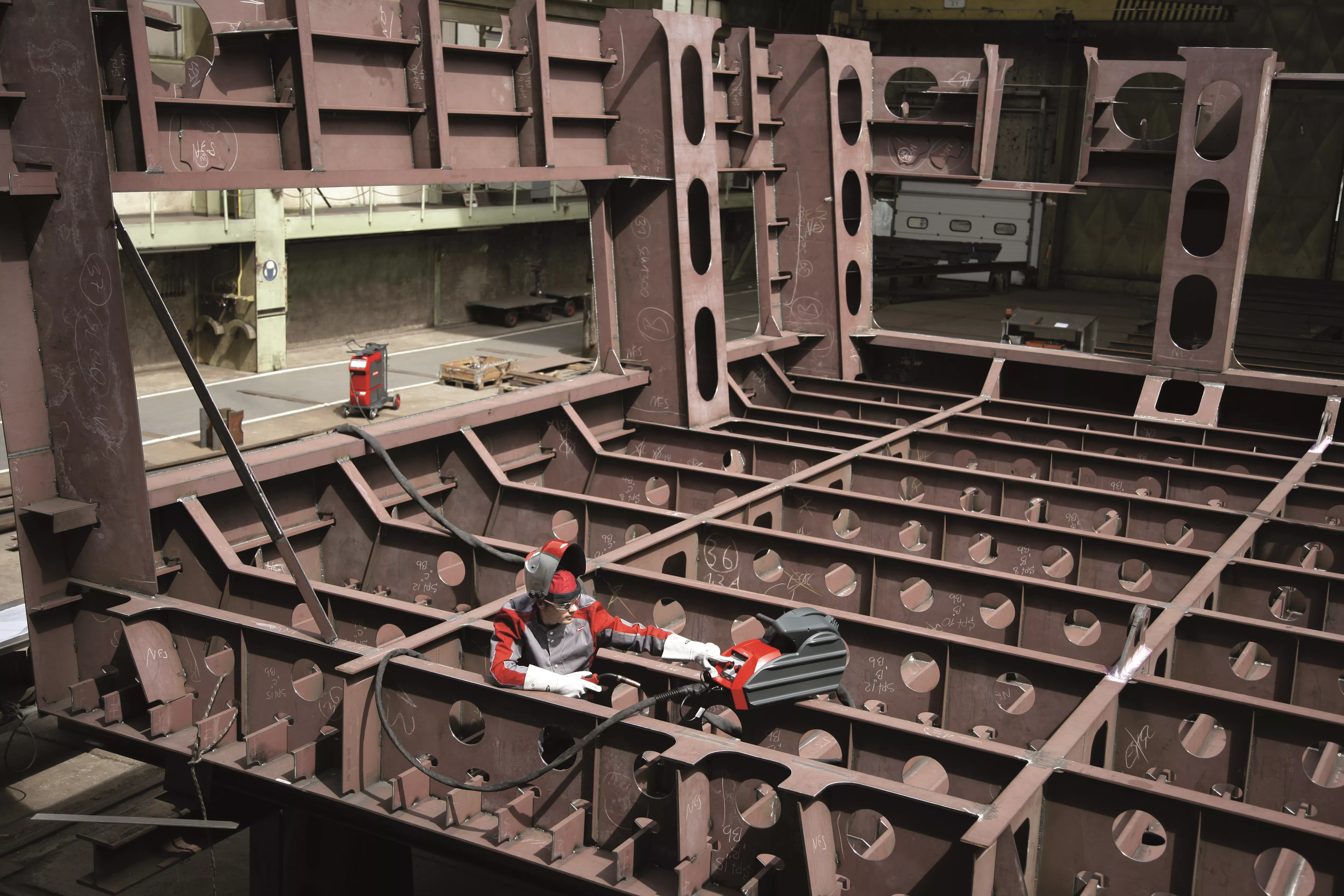

Ferries, yachts, cargo ships, giant cruise liners: Anything that transports goods or people by sea can be found in the dockyards of shipbuilders such as Blohm&Voss. In addition to the new vessels under construction, the Blohm&Voss yard also provides berths for ships undergoing maintenance and repair work as well as docking facilities for ships where mandatory inspections are required for an operating license to be granted. The average length of stay in the shipyard is one to two weeks. Fronius TransSteel and TPS /i power sources are often used here, with which up to 150 welders can be working on a single ship.
Around 40,000 merchant ships account for roughly 90 percent of the world’s goods traffic; a trend which is on the rise. Experts expect an annual increase of two to three percent by 2020. “German shipyards are full of orders for the coming years,” says Martin Juhn, Key Account Manager at Fronius Germany. Contract security, delivery reliability, and quality play a major role in the popularity of German yards. This is also reflected in the requirements placed on the welding systems used. They have to be easy to operate, designed for two or three shift operation, and robust, as the weather and frequently changing users do not exactly translate into a gentle working environment.
