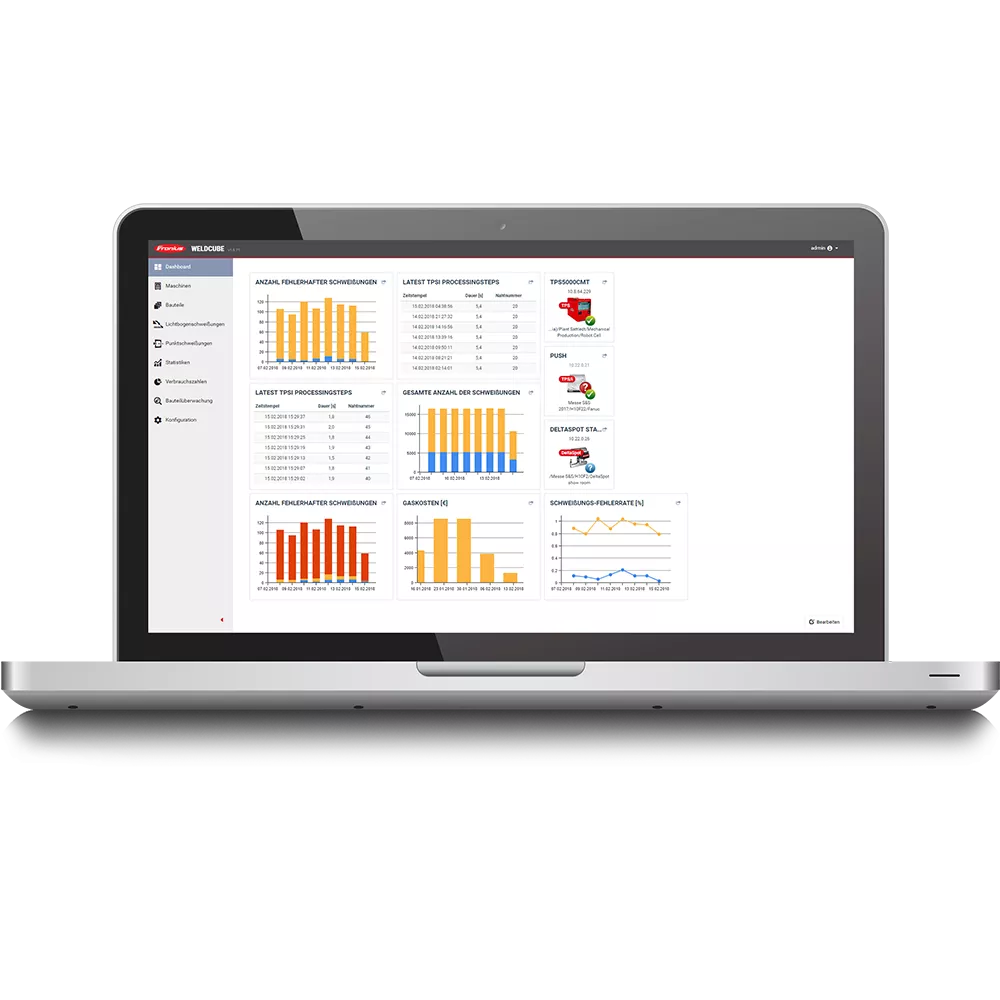

    Fronius offers the optimal software solution for the ongoing planning, collection, analysis, and visualization of welding technology production data in the form of the WeldCube product portfolio.
    Depending on the WeldCube version, welding and system data can be stored and evaluated either locally in the welding systems or centrally in a database.

    WeldCube Premium
    Centralized documentation solution
    with intelligent management, statistical, and analysis functions, as well as graphical visualization of results
    • CENTRALIZED & NETWORKED
      Significantly reduced time and effort required for documentation and administration thanks to centralized storage of the data in a database
    • TRACEABILITY
      Targeted documentation and process optimization via the component-specific collection of welding data
    • FLEXIBILIY
      Forwarding of data to third-party systems via an integrated data interface (web API)
    • COMPATIBILITY
      In addition to the new Fronius welding systems, older series can also be used with WeldCube Premium
    • USER-FRIENDLINESS
      Straightforward graphical visualization of all recorded data for quick and easy analysis. This makes it possible to quickly detect errors that develop on components over the course of several welding processes
