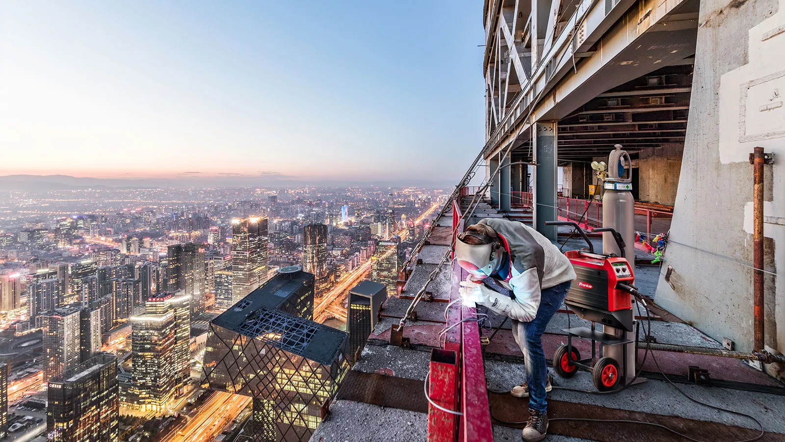

The advantages of a multiprocess welding system become clear when applied to a practical application: A metalwork fitter receives an order to carry out work on a modern building. The company uses the MAG welding process to join shelving units made from unalloyed steel in the storeroom and join the chrome-nickel stair railings. The fine weld seams on the handrail must look and feel excellent – for this reason, the TIG process is used. The final tasks are carried out on an open skywalk high up in the air. Exposure to wind and weather make it impossible to use gas shielded arc welding – this is where rod electrode welding comes into play. The best way to master all of these tasks is with a multiprocess welding system. A three-in-one solution helps to minimize the investment Costs.
