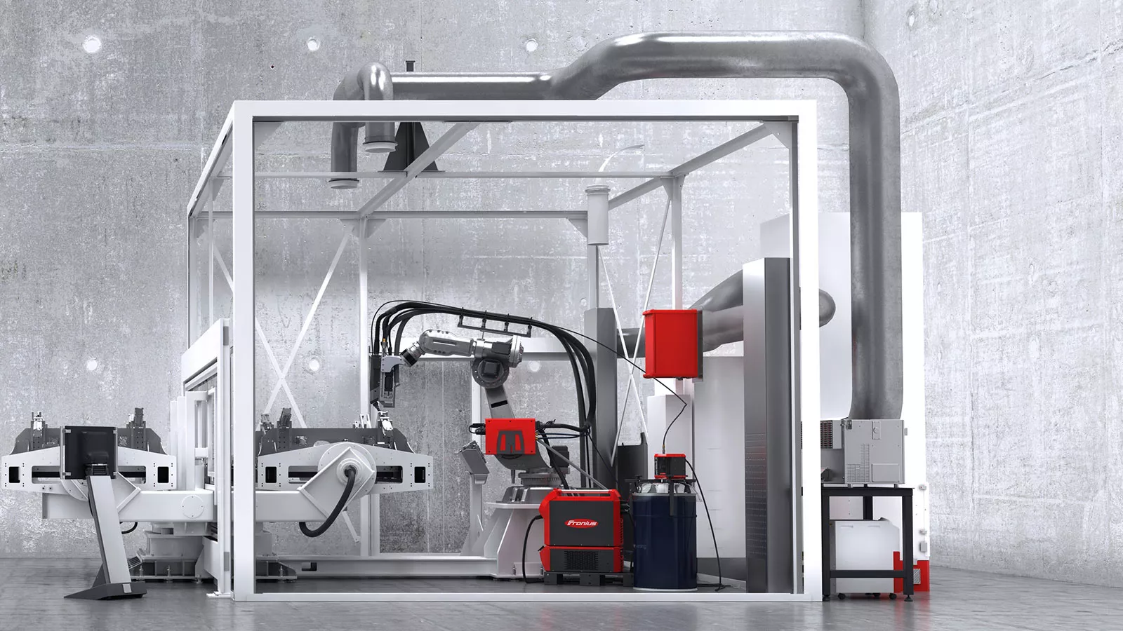

Fronius has already implemented a mechanized welding system for producing battery trays for customers from the automobile supplier industry. The welding process runs in an enclosed robot cell. An employee prepares the 1.6 x 2.2 meter trays on clamping devices in a separate safety zone. This allows the aluminum profile segments to be welded at high speed and in repeatable quality. The cleanliness of the components and the close tolerances guarantee a perfect weld seam – also reducing the amount of post-processing required. The use of a mechanized welding system therefore reduces manufacturing costs and improves levels of quality and efficiency in production.
The long seams of the battery trays are welded with great efficiency in the mechanized robot cell by the LaserHybrid welding process.
