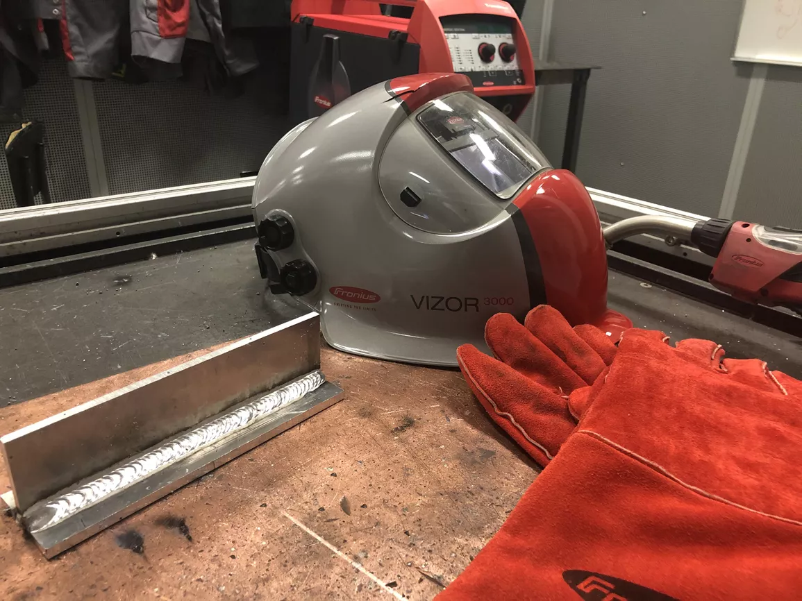

This lightweight metal conducts heat exceptionally well, making it tricky to weld, especially at higher thicknesses. The best way to get the right weld is to make sure you know which series of aluminum you’re working with and to prepare the material’s surface properly for welding.
While a clean surface is important in every weld, it is especially important when welding aluminum. Failing to clean the surface properly can cause a lack of fusion, porosity, weld cracks, and other problems leading to rework or scrapping the piece altogether.
Pre-weld Aluminum Prep
Welders know part fit-up is important in achieving a good weld. Since aluminum tends to be fluid, you need to control gaps and keep them consistent. Be sure to preheat or bevel anytime you weld material more than 3/16 in. thick. Beveling allows for full penetration without overheating the person welding, burning through parts, or exceeding the duty cycle of the machine. Good joint design and planning go a long way to ensuring a quality weld.
Unless you’ve just removed the plastic from the workpiece, make sure to degrease and remove the oxide layer before you weld. Always degrease first. Use an industrial solvent such as acetone or a citrus-based degreaser to break down oils without leaving a residue. Be careful when using chemicals because they can harm your skin or be toxic when inhaled. Never use a wire brush before degreasing. It will simply push oils into small depressions and scratches and cause problems later.
Oxides form on the surface of aluminum when it is exposed to air and can cause porosity if not removed. Most often the oxides are removed with an alkaline solution or by grinding away a small amount of material. If you choose grinding, avoid consumables such as a grinding wheel or sandpaper that can embed foreign material into the base metal, and be sure to use consumables dedicated specifically for aluminum processes. If you use a brush that’s been used previously on steel, it can deposit tiny particles in the softer aluminum surface. Wipe down the area after grinding to remove any dust or contaminants left from grinding consumables.
The amount of material to remove while grinding depends on the application. In aerospace welding, the grinding can go all the way into the base material to ensure all contaminants are removed. In most other welding, the tolerances aren’t as strict, and an alkaline solution or small amount of grinding is all that’s needed. However, be careful when using a wire brush, as it may just polish the surface rather than remove oxides.
Before moving on to welding, be sure to rinse all parts and ensure they’re dry. Damp parts can introduce oxides and cause porosity. Another reason to rinse parts is to clear away any remaining chemicals from the cleaning process. When the metal heats during welding, those chemicals can vaporize and potentially become dangerous inhalants.
