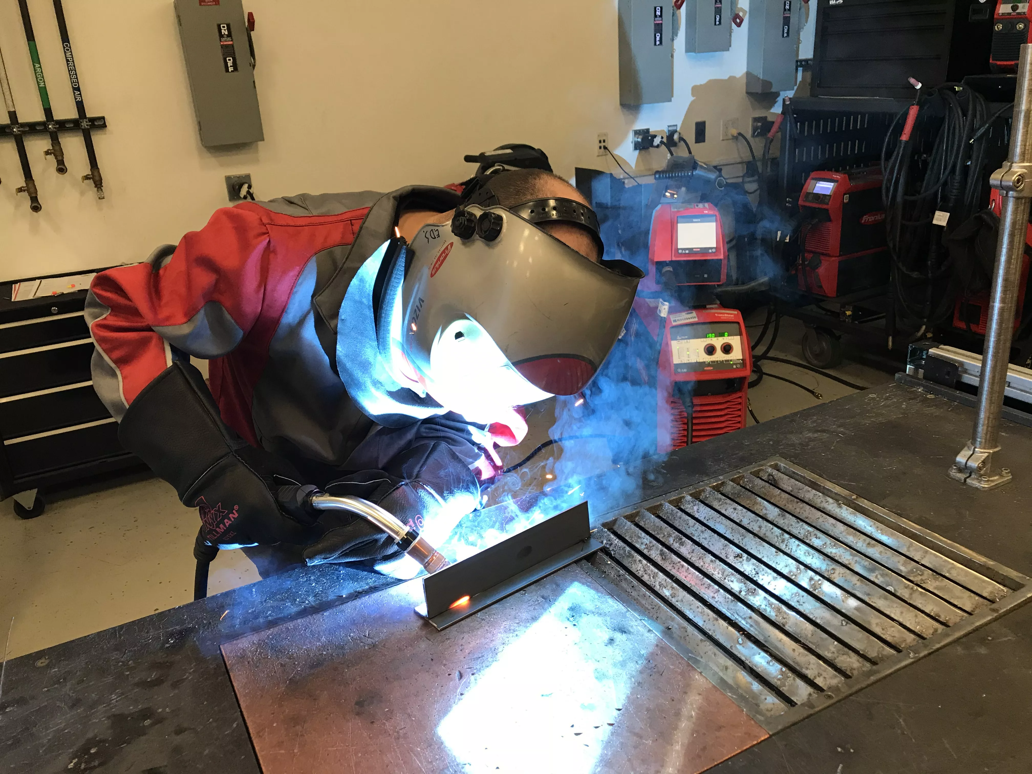

MIG welding is a skill. And just like anything else, you bring along your own style, strengths and limitations when you pick up a welding torch. There are specifics like melting points that can’t be ignored, but the parameters, methods and equipment a welder uses can be quite personal. With so many options available, MIG welding is much more than the “hot glue gun” of welding.
Parameters will differ from welder to welder because you weld at different travel speeds and manipulate the weld pool differently. Whether you’re new to MIG welding or have years behind the torch, understanding the basics can help show you how to personalize the experience and really make your welds shine.
One of the first steps in any welding process is to know your equipment, including the power source. Whether the faceplate is a few dials or a touch screen, know where to adjust the wire feed speed, voltage and inductance/pulse correction. If the equipment allows, know how to change the transfer mode and synergic line. Often the job demands quick results, and knowing how to make adjustments on the fly helps boost confidence and productivity.
