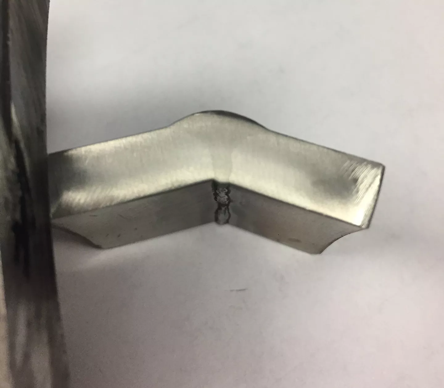

Stainless steel weld with TPS/i, Fronius USA

That consistency has helped Anderson Dahlen step more boldly into automation. A recent project included 5/16 inch walled vessels constructed of 316 stainless steel. In the past, welding the cone and dome onto the shell took several passes to complete. With the TPS/i, they were able to finish those welds in a single pass. Happy with the increase in production, they looked next to increasing their travel speeds.
They had explored sub-arc welding to reduce production times, but the thin walls of the vessel were a problem. Their top certified welding inspectors (CWIs) worked closely with the manufacturer of the sub-arc machine to develop parameters that would provide 100% penetration and travel speeds in the mid-20s. The manufacturer told them it wasn’t possible using sub-arc without blow-thru or poor penetration, unless they fabricated a copper retainer to hold back the weld puddle.
Certain they could increase the travels speeds, Stokes set up the Fronius TPS/i to run weld tests using the Pulse Multi Control process (PMC). This process offers optimized pulse welding and penetration stabilization for both manual and robotic or automated welding. The test, a single bevel joint for cone to shell attachment, showed that higher travels speeds were necessary to stay ahead of the puddle; slower speeds actually provided less penetration. Since the interior of the part required a food grade finish, they needed a specific root profile to meet the requirements. Testing showed that using a ceramic backer to create a radius in the profile of the root reinforcement would give them the best results. The backer made the final grinding easier and helped solve issues with variances in part fit up. With travel speeds around 26 inches per minute they had the penetration and profile they were looking for, and speeds almost three times faster than they’d achieved previously. This helped cement their move into automated GMAW welding.
