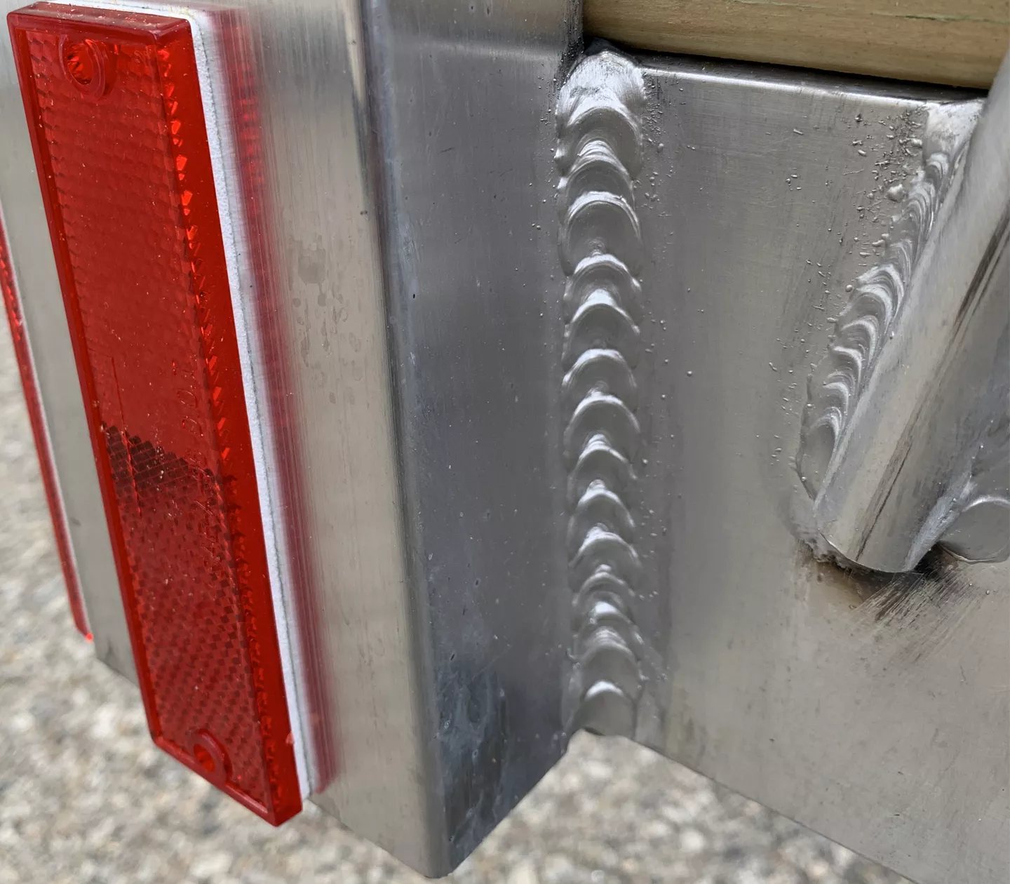

Open style trailers are useful for hauling lawn care and contractor equipment, off-road vehicles, and the occasional large purchase or move across town. By using aluminum, manufacturers like Look Trailers can keep the overall weight down, making them easy to tow and better on gas mileage. But the open style means support rails—and their welds—are visible, and those welds need to be attractive as well as secure. If not, smart consumers may wonder at the overall quality of the trailer.
This was the challenge that led Look Trailers in search of alternative welding solutions. Aluminum is already tricky to weld but add in the shortage of experienced welding staff and the challenge can seem insurmountable. Look Trailers knew they wanted that stacked-dime appearance for their welds, but cost, skill, and production time made finding equipment to do the job difficult. After a lot of research, they conducted a head-to-head test with three different brands of machines with five welding professionals from their shop. After both destructive and nondestructive testing of the welds, and the opinions of their team, Look decided that the Fronius TPS 320i best suited their needs.
The system gave the attractive welds they needed and worked with a lightweight, inexpensive push torch, instead of the bulkier, costly spool guns or push/pull style torches typical for aluminum. The Fronius push torch allows for up to fifteen feet of movement and fits easily into whatever position welding is needed, at a fifth the cost of a push/pull torch. The torch works with an adaptive arc to help overcome common problems such as lack of adhesion, porosity, or burn through, to create a solid, beautiful weld.
“The welds come out of the machine with a row of dimes that are shiny, pretty much from the start,” said TJ Repaich, General Manager of Indiana factories. “That means we don’t have to go to another station to wire brush or phosphate wash the weld just to get it to look nice. It eliminates a whole step from the process, and we can build trailers faster.”
