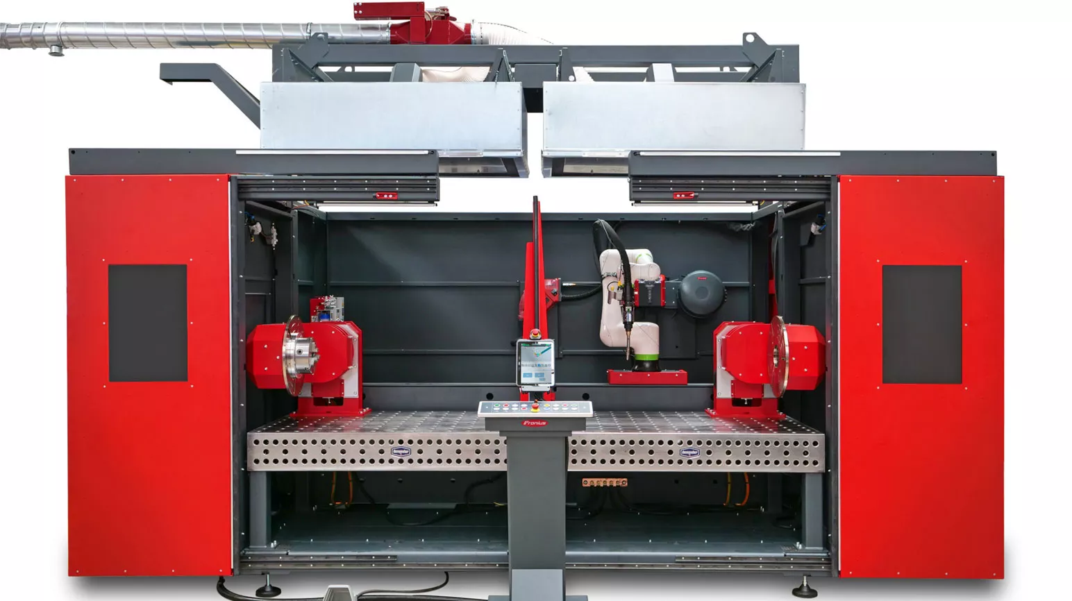

With the CWC-S and the CWC-D, Fronius offers two fully enclosed cobot welding cells for one- and two-station operation. Just like the CWC-mobile, both systems feature the latest welding technology.
The CWC-D two-station solution is ideal for welding components with a length of up to 3 meters. If you remove the central partition wall that is screwed to the welding table, this creates an extended work surface of 3,000 x 1,000 x 600 mm for one-station operation.
“With two-station operation, the system enables welding to be carried out in parallel to setup and is ideal for small-series production of components with a maximum side length of 1.5 meters. While welding is being carried out on one side, the other side can be equipped to increase productivity. Both stations can weld components weighing up to 2 tons,” explains Neuhofer.
The smaller, compact CWC-S has been specially developed for components that are no wider than 1.5 meters. Turn and turn/tilt positioners are available for both the CWC-S single system and the CWC-D dual system for circumferential welding of cylindrical components. The turn positioner is optionally available with a tailstock on the longitudinal axis. The Coordinated Motion software option, which is available for all positioners, enables the welding torch and positioner to move in sync. The Robacta Reamer V torch cleaning station is available in the range as an accessory.
