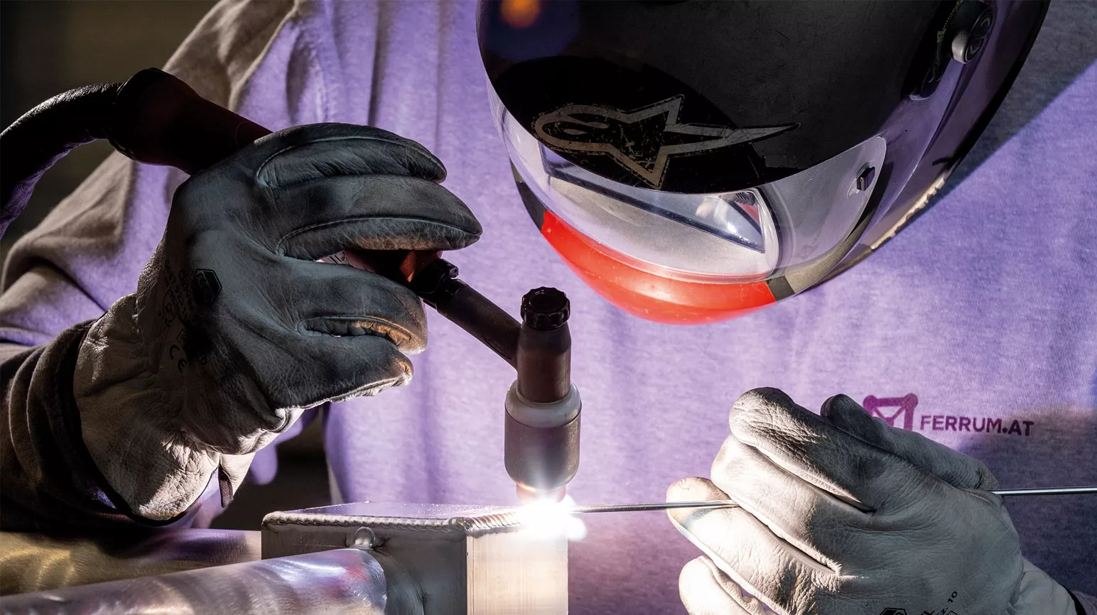

Top-quality manual welding requires years of experience and dexterity. This is especially true for TIG welding. The more intuitive and convenient a welding system is to operate and the more it supports welders with their welding work through intelligent functions, the better they can focus on the actual task: the perfect weld result. The iWave makes things much easier for the professionals at FERRUM.AT. The menu navigation is self-explanatory and available in more than 30 languages. Operating the touch display and adjustment wheel even while wearing gloves is easily possible.
“RPI auto” takes TIG welding ignition behavior to a whole new level. Adapted to the different electrode diameters, this function enables fast and reproducible ignition without any manual adjustment of the ignition parameters, regardless of the material characteristics.
If the professionals at FERRUM.AT want to repeat certain welding parameters, they can create “Jobs” in the iWave and subsequently call up to 1,000 of them on the JobMaster welding torch. This eliminates the need to move back and forth between the component and the welding system as soon as new welding parameters are needed. Recurring jobs can be saved in iWave as favorites, five of which can be set as so-called “Easy Jobs” on the welding torch. This is an enormous gain in convenience for welding tasks that have to be performed over and over again.
Depending on the job, the iWave itself recognizes when it has to change from MIG to TIG for certain applications and vice versa. It automatically changes the necessary parameter settings and lowers the main current slowly and in a controlled manner for a clean weld toe. All these functions support the welding professionals in achieving the desired weld seam quality.
