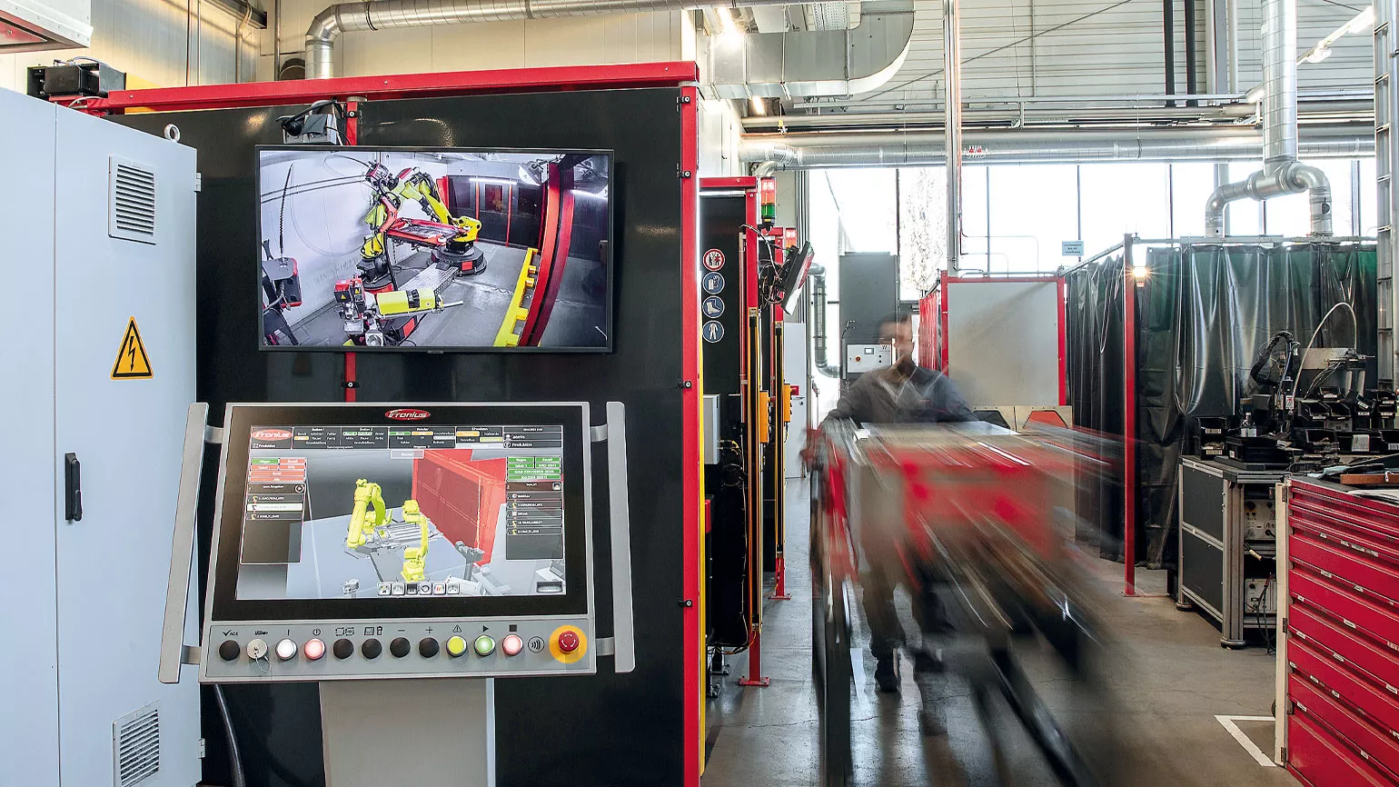

The inverter is produced at the Sattledt location in Austria. The housing and swing doors are welded in a state-of-the-art “Handling-to-Welding” robotic welding cell that has been developed specifically for this job. “We program and simulate all robot movements and welding sequences offline with Fronius Pathfinder, i.e. away from the system on a digital twin,” explains Anton Leithenmair, Head of Welding Automation. “This enables us to detect any interference contours in advance. The same applies to axis limits and torch positions. Again here we can intervene early, without having to wait until the first welding samples. As soon as the welding sequences have been programmed, Pathfinder transfers the data to the post-processor, where it is translated into the language of the Fanuc robot. This allows us to save valuable time and costs. Offline programming shortens the robot teaching process in the welding cell by several hours!”

Due to the different sheet thicknesses, the welding of the double-walled inverter housing posed a particular challenge from the outset. “Before we join the individual sheet elements in the robotic welding cell in line with standards, they are manually pre-tacked. We use the MAG welding process for this. Even at this stage, precise work is required,” says Christian Kraus, group leader in sheet metal production.
Once tacking is complete and this has been entered on the system terminal, the central system controls release the next step: robotic welding. The housing is now placed on the set-up trolley, clamped and moved into the lock. Once this has been acknowledged, the system starts the next job and the robot program responsible for positioning and welding is selected on the clamping device by means of an RFID (Radio Frequency Identification) chip.
“Regardless of which component we place in the lock, the RFID chip knows which welding program to use,” adds Kraus. “We can even place an inverter housing in lock one while welding a wing door in lock two via the component feeder. And vice-versa. The use of RFID technology enables us to weld components completely independently of their shape, size, and quantity. Whether it’s a batch size of 1 or series production – our Handling-to-Welding robotic welding cell can do it all.”
Sophisticated robot and welding technology
As soon as the welding process has been started, the Fanuc R-2000iD/210FH handling robot takes the component and guides it into the welding cell. It requires virtually no effort to lift the inverter housing. With a range of 2.6 meters, it has a load capacity of 210 kilograms, whereas the aluminum housing, including the clamping device, weighs no more than 140 kilograms. Once the Tauro housing is inside the welding cell, a data matrix code (DMC) is printed onto the base of the housing using inkjet printing technology. This contains the serial numbers of the individual Tauro housings. It is linked to the welding data recorded by the WeldCube data management software during the welding process. This means that every individual weld is 100 percent traceable.
Once the DMC has been applied, the actual welding process begins. While the Fanuc ARC Mate 100iD welding robot is doing its work and joining 5.5 meters of aluminum sheet with a total of 96 welds, the handling robot moves the housing into exactly the right position. Some of the welds require perfect simultaneous movements of both robots – the supreme art of robotic welding.
