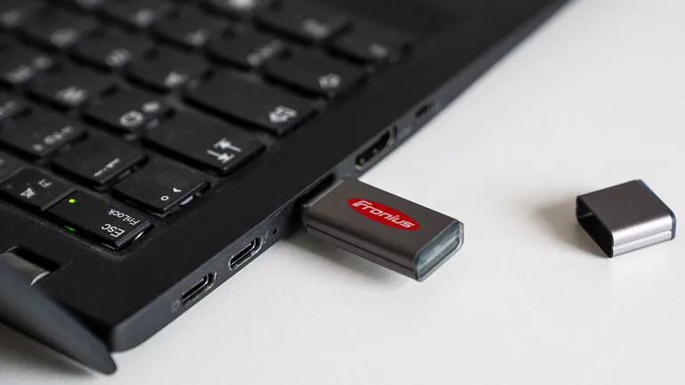

Easy Documentation
Welding data documentation for TransSteel* devices
Welding data documentation is essential, particularly in steel construction. Load-bearing steel structures, mass-produced products or sensitive parts often have to be traceable down to the final welding parameters. The Easy Documentation option enables TransSteel* to record welding data extremely easily.
*except TransSteel 2200C and 2700C and TransSteel devices with production date before July 2020
Easy Documentation PDF report
Welding data documentation in just a few steps
  1. Simply plug the USB flash drive into the back of the welding system (included with the Easy Documentation option)
  2. Check the time and date
  3. "doc | on" is displayed on the control panel
  4. From now on, your welding data will be saved as a CSV file with a Fronius signature
  5. Simply transfer data via USB flash drive, generate a PDF report and check the authenticity of the data using the Fronius signature
THE FOLLOWING DATA ARE RECORDED
  • Power source ID
  • Firmware version
  • Serial number
  • Process (Manual, Standard, Pulse, TIG, MMA)
  • Current / voltage / wire speed in the main process phase
  • Power from instantaneous values “IP” (Instantaneous Power) - energy / time (in the main process phase)
  • Energy from instantaneous values “IE” (Instantaneous Energy) over the entire welding operation
  • Motor current (in the main process phase)
  • Time stamp hh:mm:ss when current starts to flow
  • Counter
  • Welding duration
  • Error no. when welding is terminated
  • Wire speed (metric and imperial)
  • Characteristic number
  • Operating mode (2T, S2T, 4T, S4T, spot welding, stitch welding, SynchroPulse)
  • Signature for each weld seam number
  • Template for .csv file
  • Easy Job number
