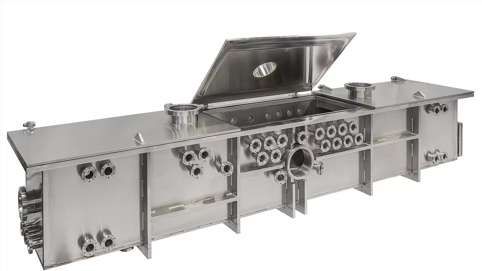

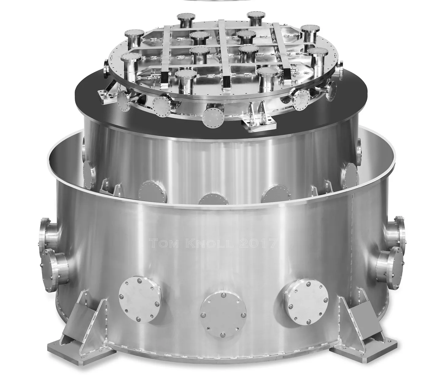

    REQUIREMENT
    Originally focused on stainless steel, they’ve incorporated many specialty alloys into their work. One of the applications required small stainless steel welds with minimal rework,since the welds would have to be ground down and blended to an aesthetic finish.One recent challenge included vacuum chambers with varying wall thicknesses of 1-2 inches made of aluminum. Due to the large size of the chambers, all welds were done in position. For this application, the ability to switch between previously saved job programs right on the torch helped to increase production times. It also reduced the need for repairs because each job was tested prior to saving.This meant their weld professionals could work at a higher efficiency overall.
    SOLUTION
    Fronius TPS/i. The GMAW machine boasted a consistent, precise arc, which seemed to fit the needs of the project. That first machine outperformed their expectations on more than the original challenge, traditionally a GTAW operation, they now use TIG far less, and mostly for specialty projects. In some cases, by using the Fronius GMAW processes they’ve been able to increase their production speeds by three times their previous output, especially with automated welding. One such automated application required vacuum chambers fabricated of 304 stainless steel. Each vessel, chamber, and chamber door were welded on the turntable with the TPS/i. The project was completed faster than usual due to a lack of repair work and a decrease in down-time. “I couldn’t believe how many quality welds we could make at a time, and without going through as many consumables,” said Stokes. “That’s really the root of what we fell in love with,that consistency.”
