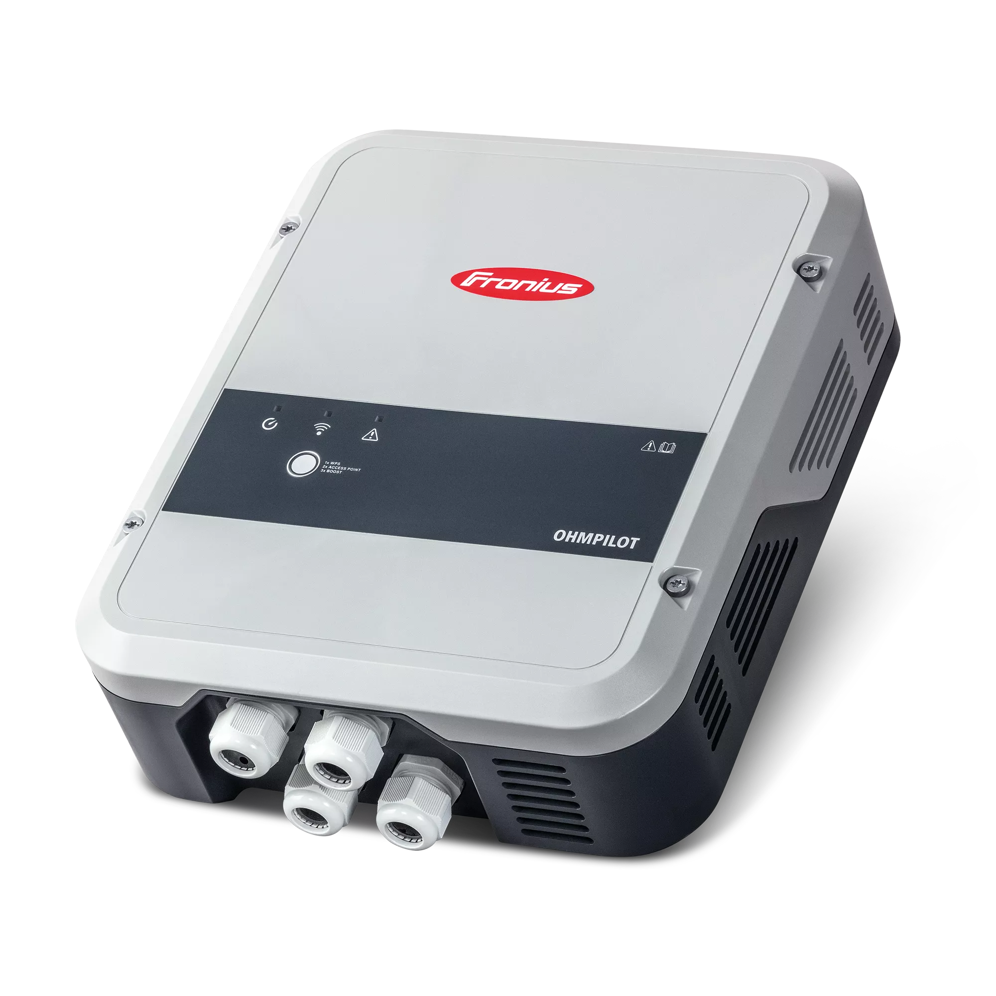

Fronius Ohmpilot
Designed to heat.
More self-consumption for more independence: this is exactly what the Fronius Ohmpilot was developed for. With our Fronius Ohmpilot secondary regulator, even the smallest amounts of surplus photovoltaic energy can be used for hot water treatment and heating – right down to the very last watt. Fronius Solar.web gives you a convenient way to demonstrate the Fronius Ohmpilot, impressing customers with how quickly they can recoup the investment costs of their photovoltaic system by making the most of self-generated energy. Fronius Ohmpilot. Designed to heat.
Technical Data
Input Data
Frequency (Input)50 Hz
Max. input current (Iac max1)
1x16 A / 3x16 A
Input voltage 1)
3~NPE 230 V (400 V)
Output Data
AC output current (Iac nom1)
1x13 A / 3x13 A
Output voltage 1)
3~NPE 230 V (400 V)
Frequency (Output)50 Hz
Max. output power3 kW / 9 kW (each continuously adjustable)
General Data
Dimension / width280 mm
Dimension / height350 mm
Dimension / depth110 mm
Weight3,9 kg
Type of power regulationPulse width modulation
Protection classIP54
InstallationWall mounting
Ambient temperature range0 - 40 °C
Permitted humidity 2)
0 - 99 %
Certificates and compliance with standardsCE, EN 61000-6-2, EN 61000-6-3, EN 61000-3-2, EN 61000-3-3, EN 300 328
Certificates and compliance with standardsEN 61000-3-2, EN 61000-3-3, EN 300 328
