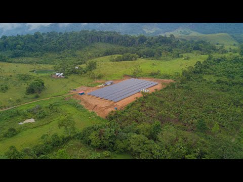

Atalaya is becoming a pioneer in power generation with the smart PV-Genset. The solar power plant is connected to the existing hydropower plant and thermal power plant, ensuring a reliable and cost-effective power supply. Thanks to an intelligent control system, the use of solar energy is prioritised in the PV-Genset system.
The PV system consists of 14 Fronius Eco inverters and 1,260 solar modules, all managed by a control system from Elum. This controls the entire system and ensures that all energy flows between the generators and the loads are coordinated.
System Data:
Size of installation
500 kWp
System type Open air system
Fronius components
14 x Fronius Eco
Loads 12.000 inhabitants of Peru
Annual yield
Approx. 650.000 kWh
CO2 saved / Jahr Approx. 193,5 tonnes
