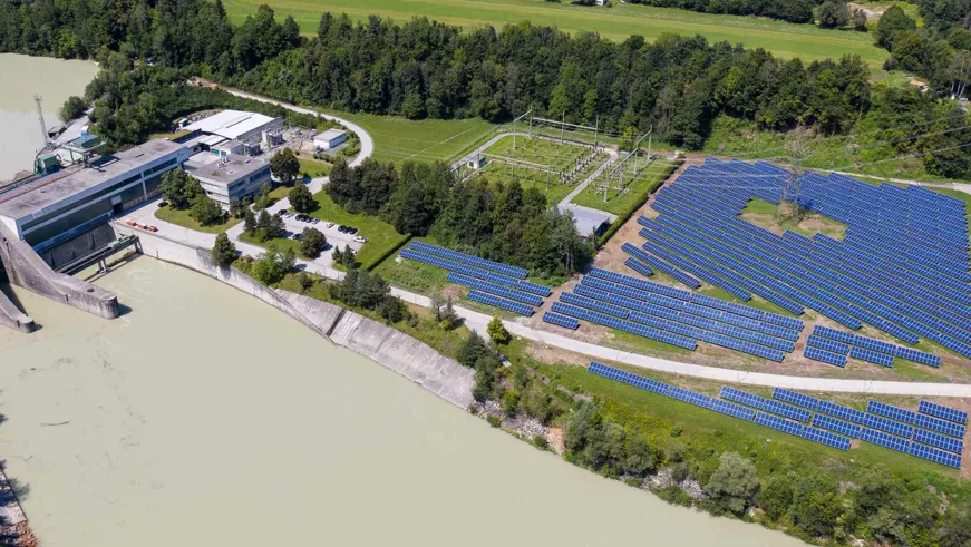

1.3 MWp PV power plant with Fronius Tauro
Learn more about the first reference here:
