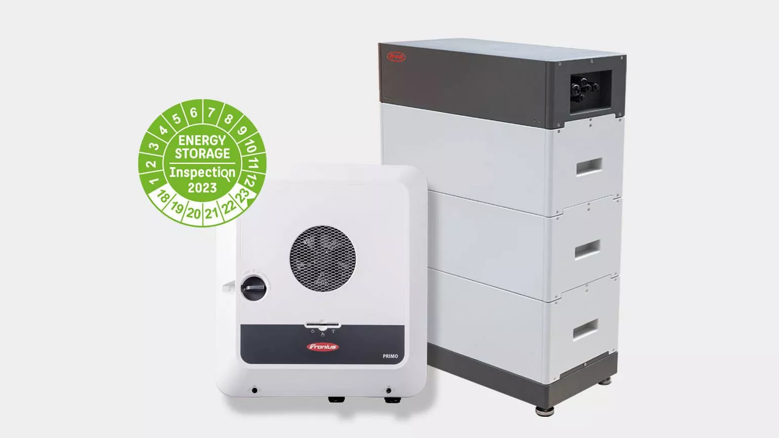

3 years top grades
The current Energy Storage Inspection 2022 has analysed and compared the storage efficiency of 21 systems. As in the previous year, Fronius and BYD are way out in front, taking 1st and 2nd place in the two test categories. Fronius is thus the only manufacturer of hybrid inverters to have achieved the highest efficiency rating in both categories.
