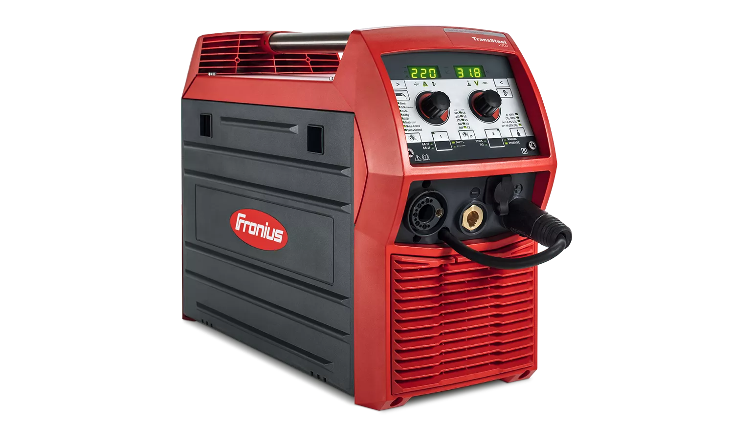

TransSteel Compact
No matter what the welding task - MIG/MAG, TIG and electrode welding with just one device.
Whether a construction site or a workshop, from agricultural enterprises to metalworking companies – for assembly, repair, and maintenance work, the TransSteel Multiprocess series masters the MIG/MAG, TIG, and electrode welding processes to professional levels.
The TransSteel 2200 is a compact, 3-in-1 solution. It is the first single-phase inverter power source from Fronius that is also multiprocess-capable, bringing together MMA, MIG/MAG and TIG in a single device. The TransSteel 2200 is characterised by the intelligent design of the device, ease of use, robustness and a high level of reliability. Weighing only 15.5 kg, it is also one of the lightest devices on the market.
