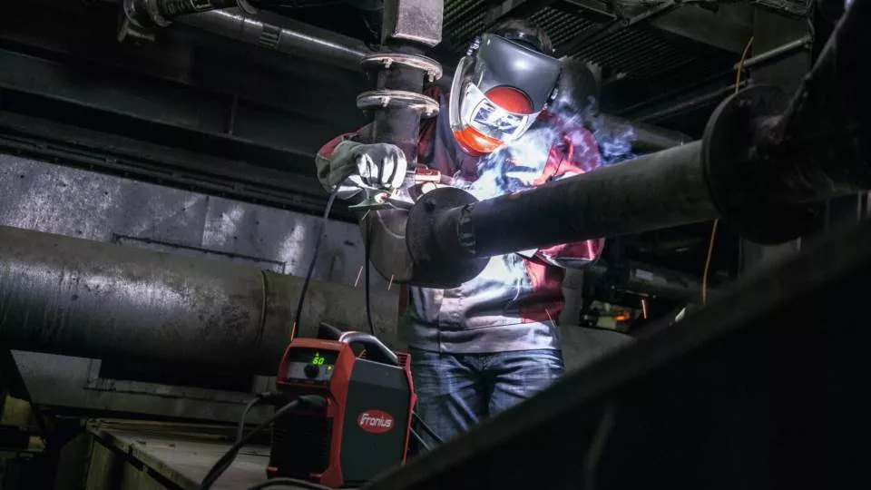

Electrode welding (also known as manual arc welding, stick welding, or E-hand welding) is usually the first welding process that professional welders learn during their training. It is easy to learn, but already provides insights into how welding machines work and the relationship between metals and electrical voltage.
Welding with a stick electrode offers numerous advantages over MIG/MAG and TIG processes. In principle, almost all materials can be welded with an electrode. The process is mainly used in steel and pipeline construction, but also in metalworking and the metal industry. Manual metal arc welding allows for any type of weld seam and position, whether in awkward or overhead positions, vertical or vertical downwards welding. In addition, welders are independent of protective gases and can work outdoors without any problems, even in unfavorable weather conditions such as wind or rain.
Manual metal arc welding: this is how it works
In electrode welding, contact between the rod electrode and workpiece ignites the arc. This creates a short circuit for a fraction of a second between the two poles, meaning that current can then flow. The arc burns between the workpiece and the electrode. This creates the required fusion heat. Via the consumable core wire and the coating, which is also consumable, the electrode also supplies the protective slag and the gas shroud.
Manual arc welding requires a low voltage and a high amperage. The welding system converts the available mains voltage into a significantly lower welding voltage. At the same time, it provides the required amperage, which also allows the power source to be adjusted and regulated.
In manual metal arc welding, the amperage is the most important parameter for the quality of the connections. It must therefore remain as constant as possible, even if the arc length changes. In order to ensure this, power sources for electrode welding always have drooping characteristics.
