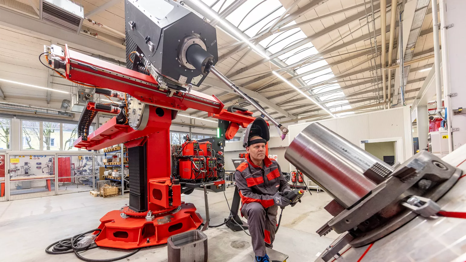

ETR-S Advantages
  • Synchronized movement axes allow for the welding of complex component shapes
  • Considerably reduced setup times due to automatic determination of the component position in the 3D space
  • SpeedClad 2.0 compatible – up to three times better cladding performance in comparison with conventional TIG HD welding processes
  • HMI-T21 system controls – the new generation of control with an expanded scope of functions

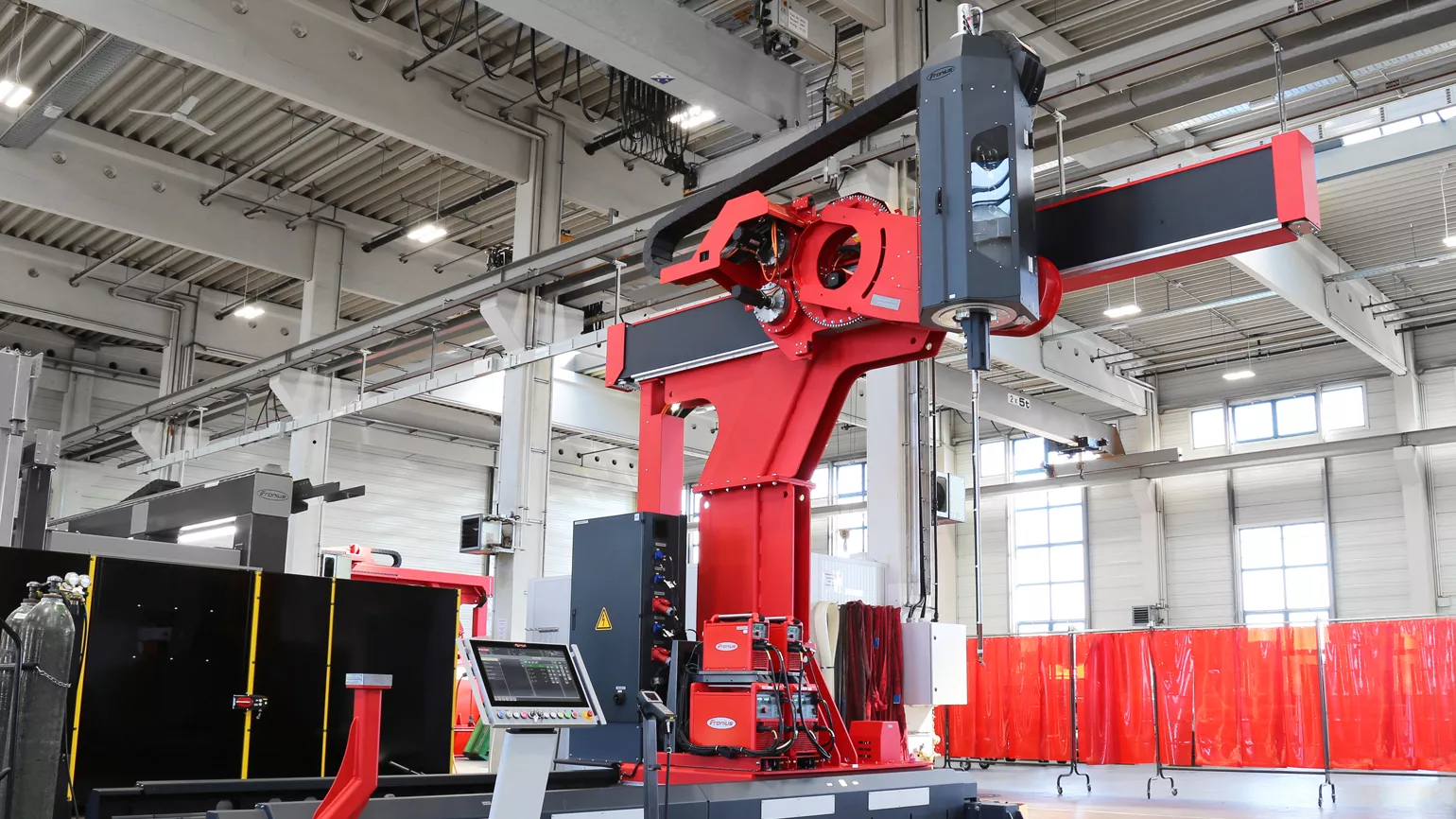

ETR Ultimate Advantages
High-end cladding system
  • Expanded working area due to motorized track
  • Complex component shapes
  • Multi station operation (fully automated)
  • SpeedClad 2.0 compatible HMI-T21 system controller
System Overview ETR Ultimate
* Only in combination with CAD import option

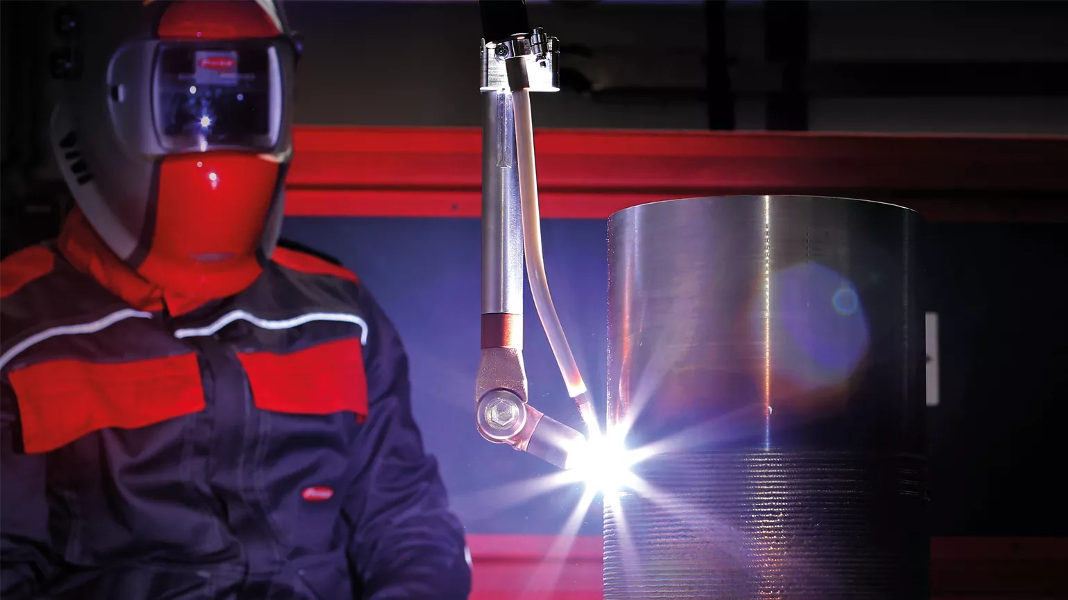

ULTRA FAST OVERLAY WELDING SpeedClad 2.0
A new dimension in cladding
In comparison with SpeedClad Twin, the new cladding process only requires one electrode and one additional wire for the same or quicker welding speeds. Considerably fewer wear parts and less maintenance work are clear benefits of this process.
In addition, the much slimmer welding torch allows for the surfacing of small interior diameters.
