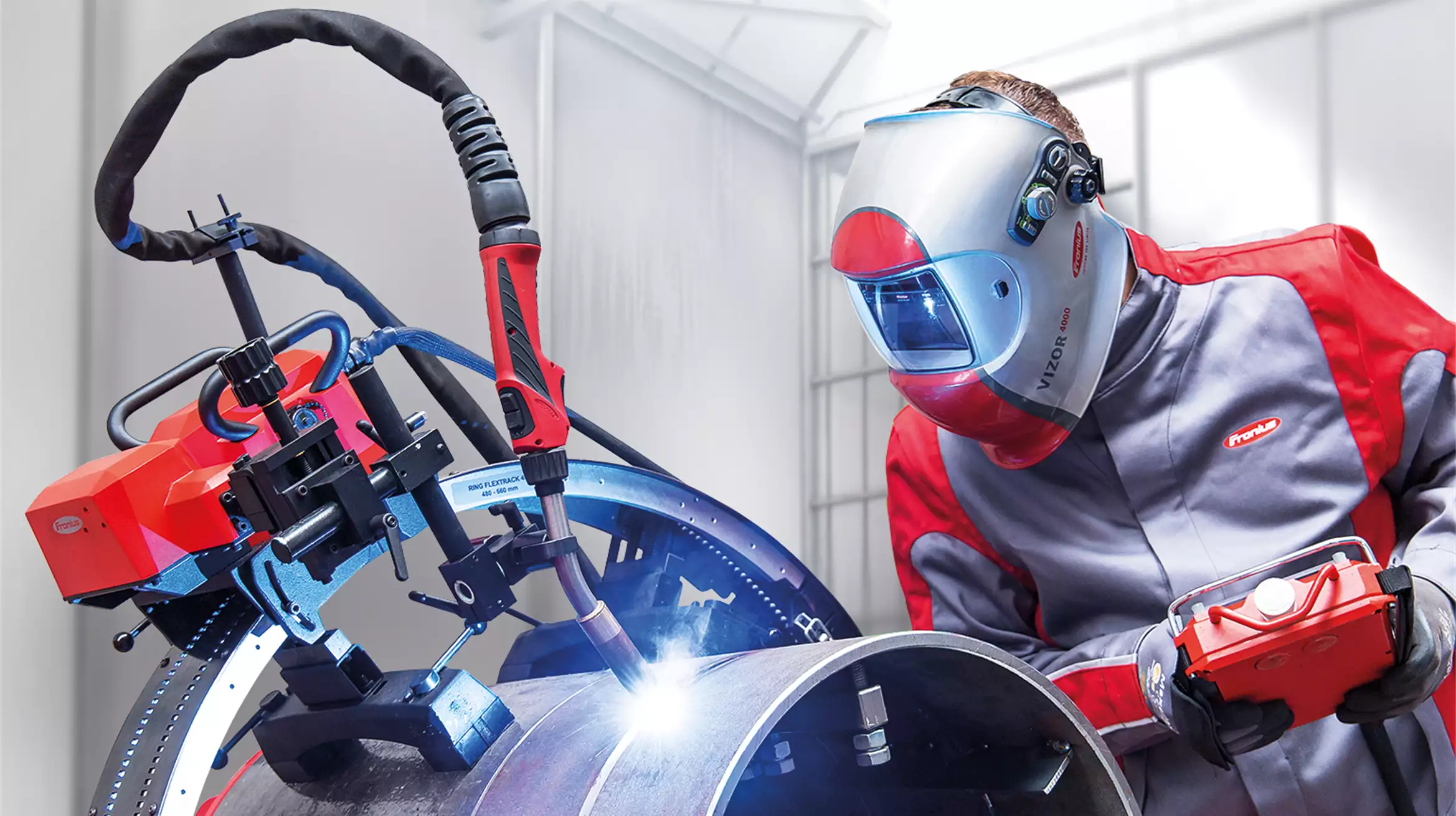

The compact welding tractor can be used in a wide range of applications. Depending on the requirements, one of three different rail types can be selected. FlexTrack 45 Pro welding tractors are perfect for all-round use in industries where surface geometries vary, for example in shipbuilding or container construction.
Contact
Fronius welding tractor FlexTrack 45 Pro
Fronius Welding Automation - system solutions
Welding tractor FlexTrack 45 Pro, oribital welding
FLEXTRACK 45 PRO STANDS FOR:
  • Flexibility for orbital and longitudinal seam applications
  • Fast production processes
  • Improvements in output quality
  • Reduced costsIncreased competitiveness
SYSTEM HIGHLIGHTS.
  • Flexibility: Modular rail concept for different welding applications on different component geometries
  • Comfort: Quick and easy set-up of rails and carriage
  • Precision: Precise movements and constant welding speed
  • Quality: Perfect reproducibility of welding results, particularly in conjunction with TPS/i power sources
  • Robustness: Compact cast aluminium housing, ideal for use under harsh conditions
