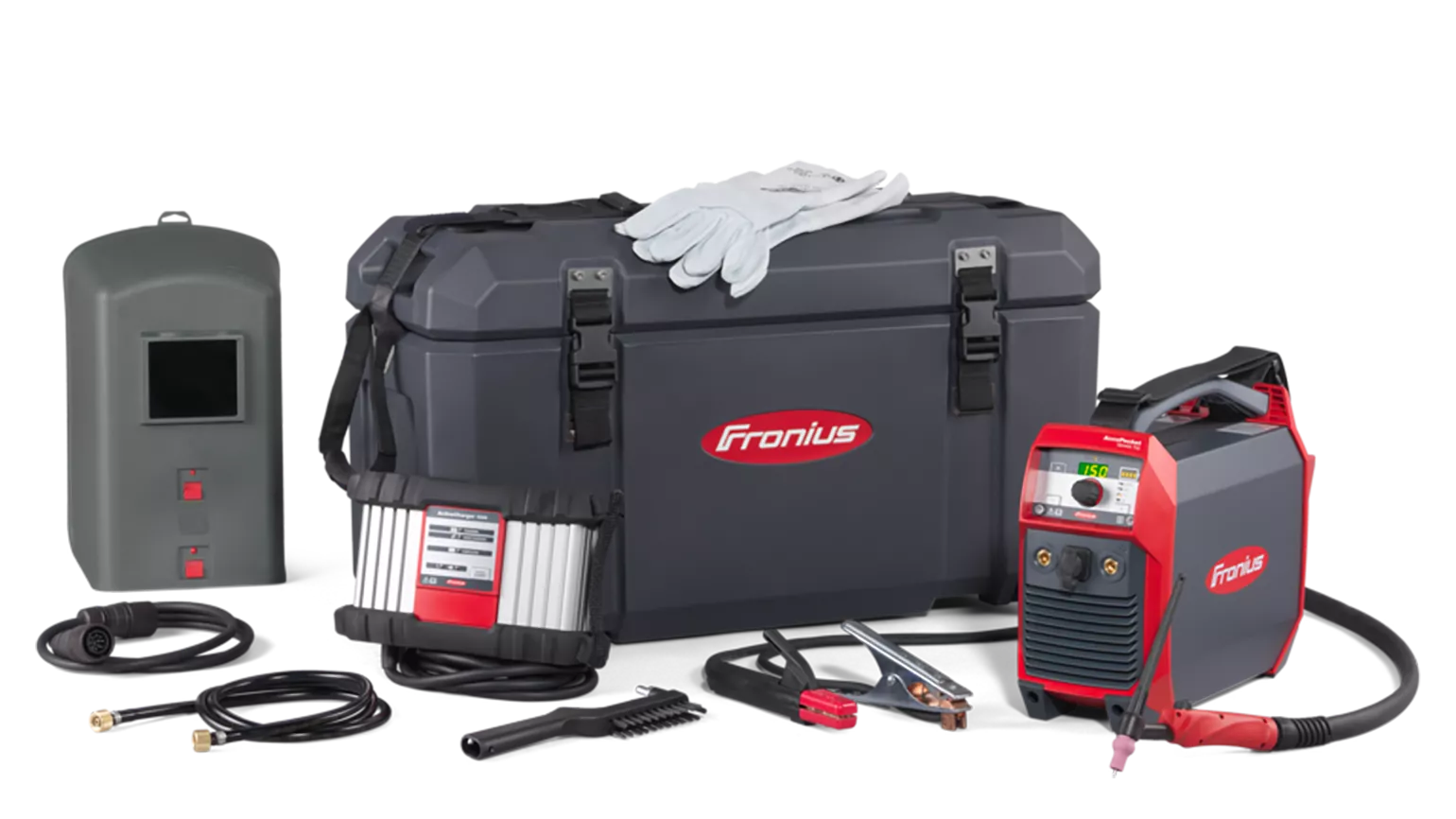

With the AccuPocket, access to mains electricity is no longer necessary. Welding tasks involving up to eight 3.25 mm or up to eighteen 2.5 mm electrodes can be carried out autonomously. A small, compact 2 kVA generator is sufficient for welding applications on a larger scale. And all without any restrictions on welding power or the quality of the arc. The very latest functional design, with dimensions reduced to a minimum, a low weight and a robust construction, make AccuPocket the perfect partner on any construction site.
Product details
GENERAL DATA
Mains voltage52,8V DC Ladespannung
Welding current min.10 A
Welding current max.140 A
Open-circuit voltage91 V
Degree of protectionIP23
Length
435 mm
Width
160 mm
Height
310 mm
Weight18,81 kg
Interference emission classA
The power sources are available in country-specific variants, meaning they can also be used in regions with differing mains voltages. For more information, please contact your local Fronius contact.
To make the electrode easier to ignite, the current at the power source is increased for a fraction of a second during ignition. The HotStart function was specially developed for welding with rutile and Cel electrodes.
The SoftStart function ensures a stable arc at the start of welding and was specially developed for electrodes that are welded with a low welding current (basic electrodes).
If a short circuit occurs that causes the electrode to stick during MMA welding, the power source is switched off immediately. This prevents the electrode from burning out.
