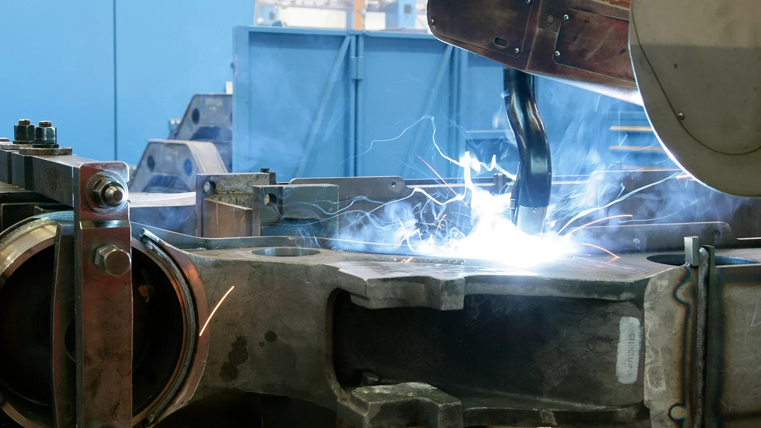

Welding process for steel
In principle, all welding processes are suitable for joining steel. However, the MIG/MAG process is primarily used because this allows for the highest welding speeds.
