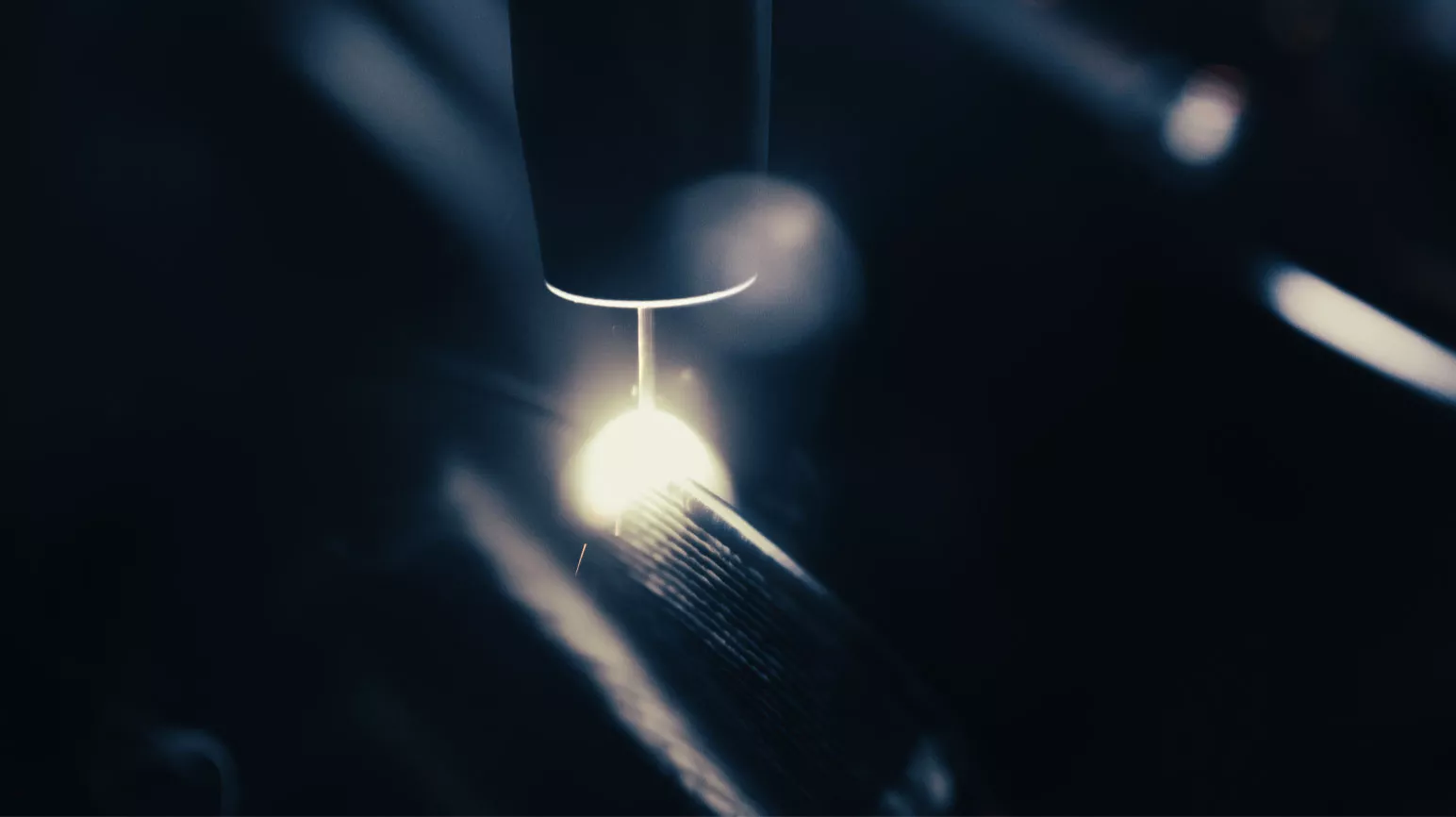

“The right welding path with the right welding parameters and processes is crucial for a good result in metal 3D printing,” explains Philipp Roithinger, an expert in additive manufacturing at Fronius International GmbH. “However, this requires a high-performance welding system that precisely ensures the accuracy of the welding torch.” The new iWave Multiprocess Pro combined with the Fronius CMT Additive Pro characteristic is optimized for metal 3D printing. This perfectly adapted equipment is now available. This complete solution is compatible with common robot systems for additive manufacturing and opens up a whole host of possibilities.
The USP: exclusive 3D features combined in one welding characteristic
With CMT (Cold Metal Transfer), Fronius has been offering a highly stable, easily controllable and comparatively cool welding process for decades. This is already the preferred method for 3D printing around the world. It therefore makes total sense that the Austrian innovation leader has now optimized CMT specifically for metal 3D printing and put all the know-how it has amassed into the development of Fronius CMT Additive Pro. The integrated arc-on rate stabilizer ensures a consistent wire speed, resulting in an even and predictable build-up of layers. This significantly improves the overall stability of the manufacturing process.
“Another innovation is the adjustable heat input, which ensures consistency in the height and width ratio of the bead, regardless of the current temperature of the base material or the previously welded layer. Weld layers usually become wider and flatter as the component heats up,” explains Roithinger. “The power correction feature counteracts this, so that identical welds can be stacked on top of each other, layer after layer.”
The start of the weld within the construction process is another important criterion for metal 3D printing. Welding errors or cambers in the area where the weld was started can affect the quality of the result. Fronius has the perfect solution to this with the Pulsed Hot Start function, which simultaneously achieves sufficient penetration and a constant layer height by starting welding within the pulsed arc. Here, the whole process is controlled automatically, so no extra settings are necessary.
The Fronius development team has added valuable features to CMT for optimal 3D printing results, and combined everything in one characteristic. And the team of experts at the Fronius prototyping center are on hand to come up with even more solutions for demanding welding challenges.
