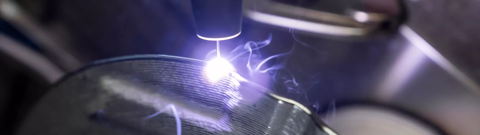

    CMT – a stable arc with no exceptions
    The synergy between stability and flexibility is crucial to producing components in additive manufacturing as well as a reliable welding process and efficient heat management.
    Thanks to its revolutionary reversing wire movement, the CMT process is extremely stable, making it a perfect solution for additive manufacturing. Layers are built up consistently, evenly, and virtually spatter-free,
    ensuring that the welded layers and components produced meet the highest standards of quality.

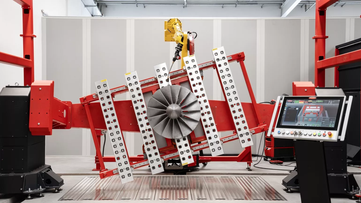

    At our prototyping center in Wels, Upper Austria, we guarantee maximum confidentiality with several robot cells and systems that are partitioned off from one another across 900 m2.
