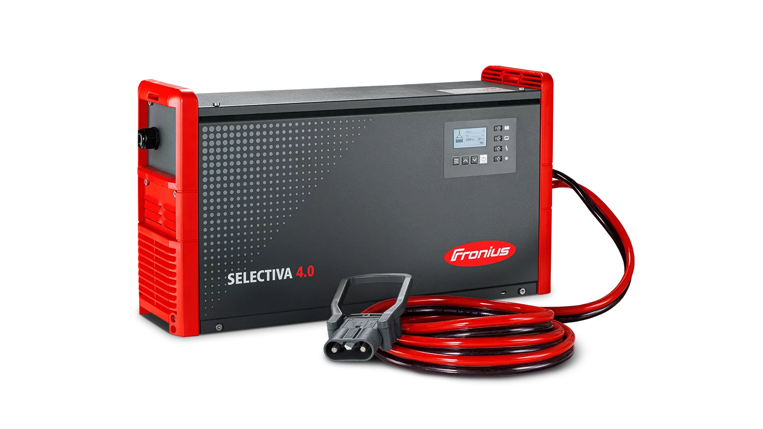

Battery chargers 4.0 for 48 V / 36 V batteries
One battery charger for every battery
The battery chargers from the Selectiva product family offer flexible charging of batteries with different voltages and capacities. Among the benefits for you are the simple and standardised operation and amount of space needed as well as low operating costs.

Τεχνικά χαρακτηριστικά
TECHNICAL DATA
| Mains voltage | 400 V (-10% / +30%) |
| Mains Frequency | 50/60 Hz |
| AC input current in A effectiv | 9 A |
| Mains fuse | 16 A |
| Nominal Power | 5710 W |
| Duty Cycle | 100 % |
| Residual current Circuit Breaker | B |
| Minimum Mains Lead Cross Section | 2,5 mm² |
| Nominal output voltage | 48 V |
| Charging current / output current nominal | 75 A |
| Dimension / l | 633 mm |
| Dimension / h | 344 mm |
| Weight | 23 kg |
| Ambient Temperature Range | -20°C / +40°C |
| Maximum Relative Humidity | 85 % |
| Maximum Altitude above Sea level | 2000 |
| Protection class | 20 |
