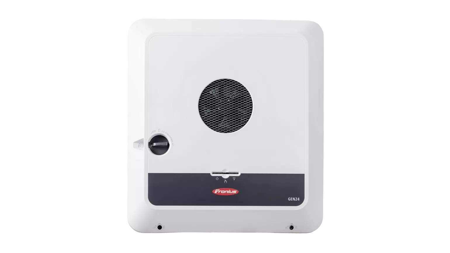

The string inverter for residential PV systems with integrated backup power
The Fronius GEN24 maximizes energy production and performance. Innovative software, high efficiency and advanced functionality make this inverter optimal for homeowners looking to start or enhance their energy independence. Even in shaded areas, the Fronius GEN24 delivers maximum yields.
Even more assurance for self-sufficient individuals: Equipped with PV Point, the Fronius GEN24 offers a integrated backup power function that supplies connected devices with reliable solar power when the sun is shining.
The Fronius GEN24 Plus hybrid inverter even enables a battery storage system to be used, providing an increased energy for crucial and entertainment loads, even at night.

Energy supply needs security. The Fronius GEN24 therefore offers an integrated basic backup power supply. Connected devices up to 3 kW are supplied with backup power via the PV Point - a protected outlet - as long as the sun is shining.
The Fronius GEN24 Plus allows users to choose between two backup power options – a basic backup power supply with the PV Point, which supplies selected electrical consumers via a protected socket, or an Essential Backup* power function which can supply a wide range of  household items, such as refrigerators, water pumps, lighting systems or an internet router.
