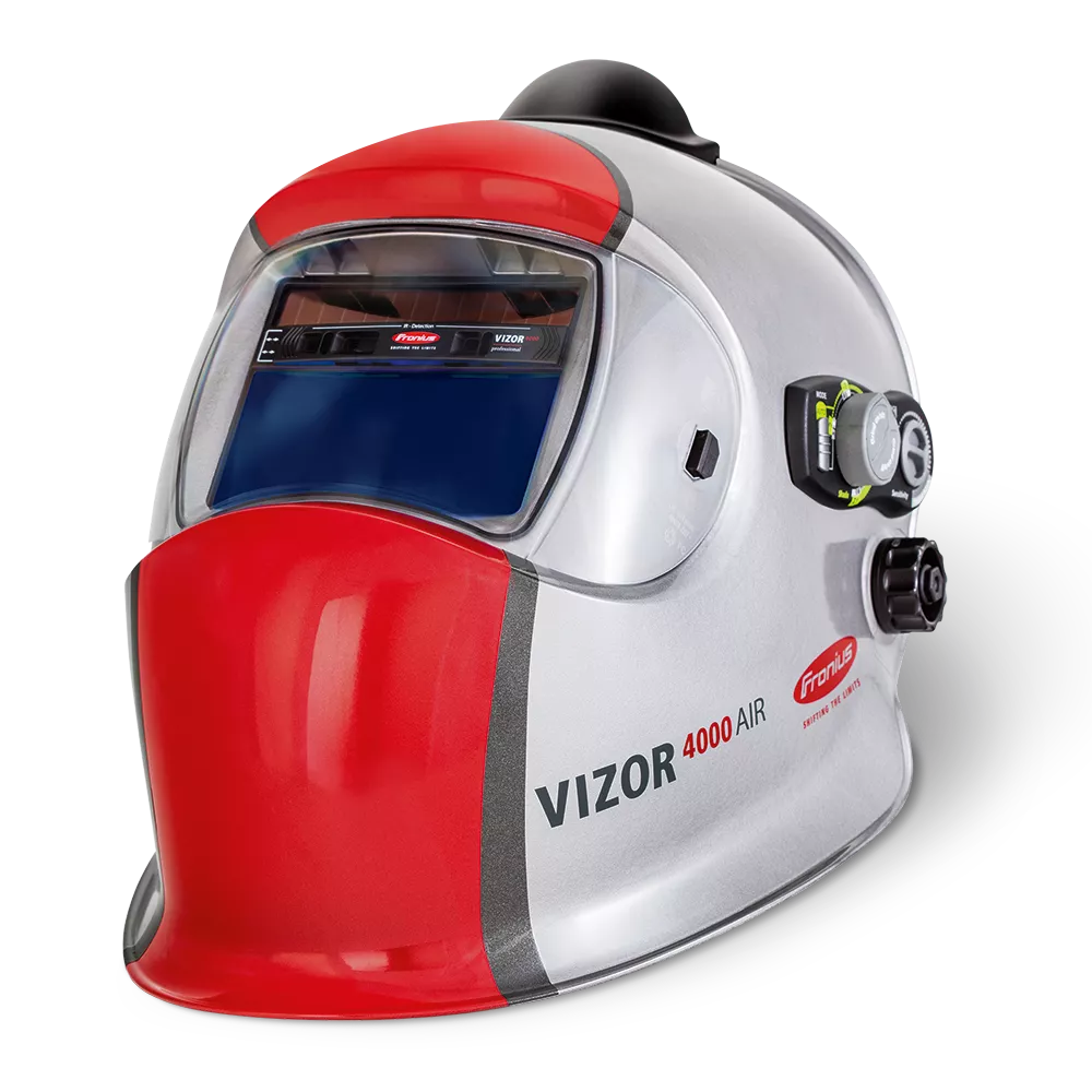

Protective clothing for welding professionals
Everyday welding work presents many challenges: UV radiation and welding fumes can pose a health hazard without suitable protection. The right equipment and appropriate clothing make all the difference here.
More about Fronius protective equipment
