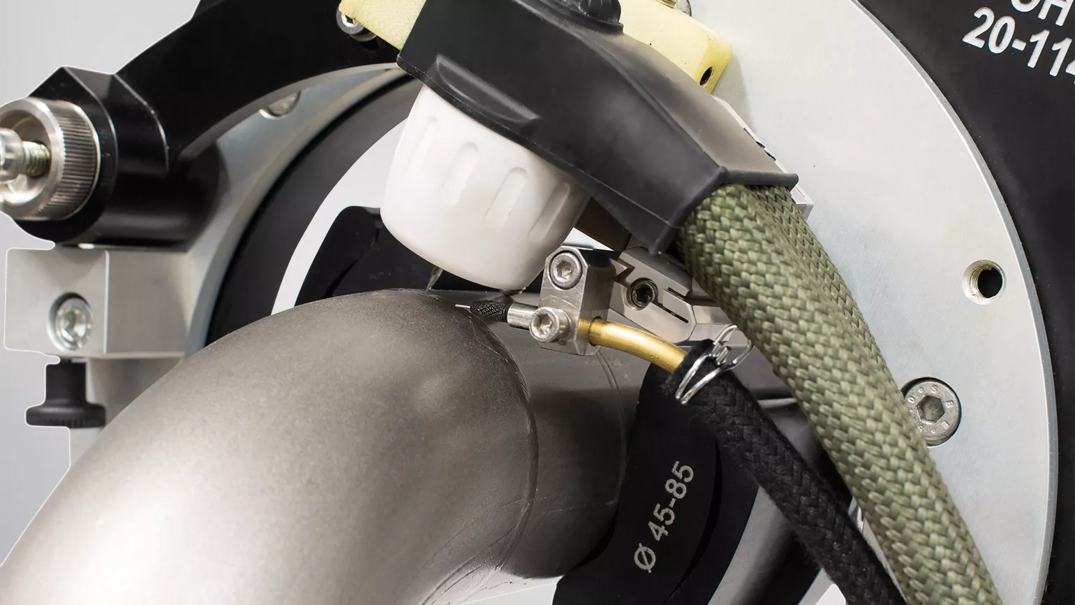

Open welding head with component
SPOT-ON VERSATILITY.
  • FOH welding head with up to two sets of reducing jaws, depending on the type of welding head
  • Integrated servo motor
  • Automatic movement to the opening position
  • Freely definable start position
  • Automatic switch-off of the motor current in the event of overloading
  • Continuously adjustable clamping/centring system for quick adjustment to the tube diameter
  • Mechanical tube tracking for constant electrode distance
  • Torch mounting 0 - 45°, continuously adjustable
  • Manual lateral correction of the electrode
  • Swivelling torch holder with fixing
  • Plug-in control line (6 m)
  • Orbital welding torch with insulated torch body and high duty cycle
  • Best possible gas shield and low level of temper colouration
  • Welding torch with simple wearing part replacement system
  • Transport case with trolley function

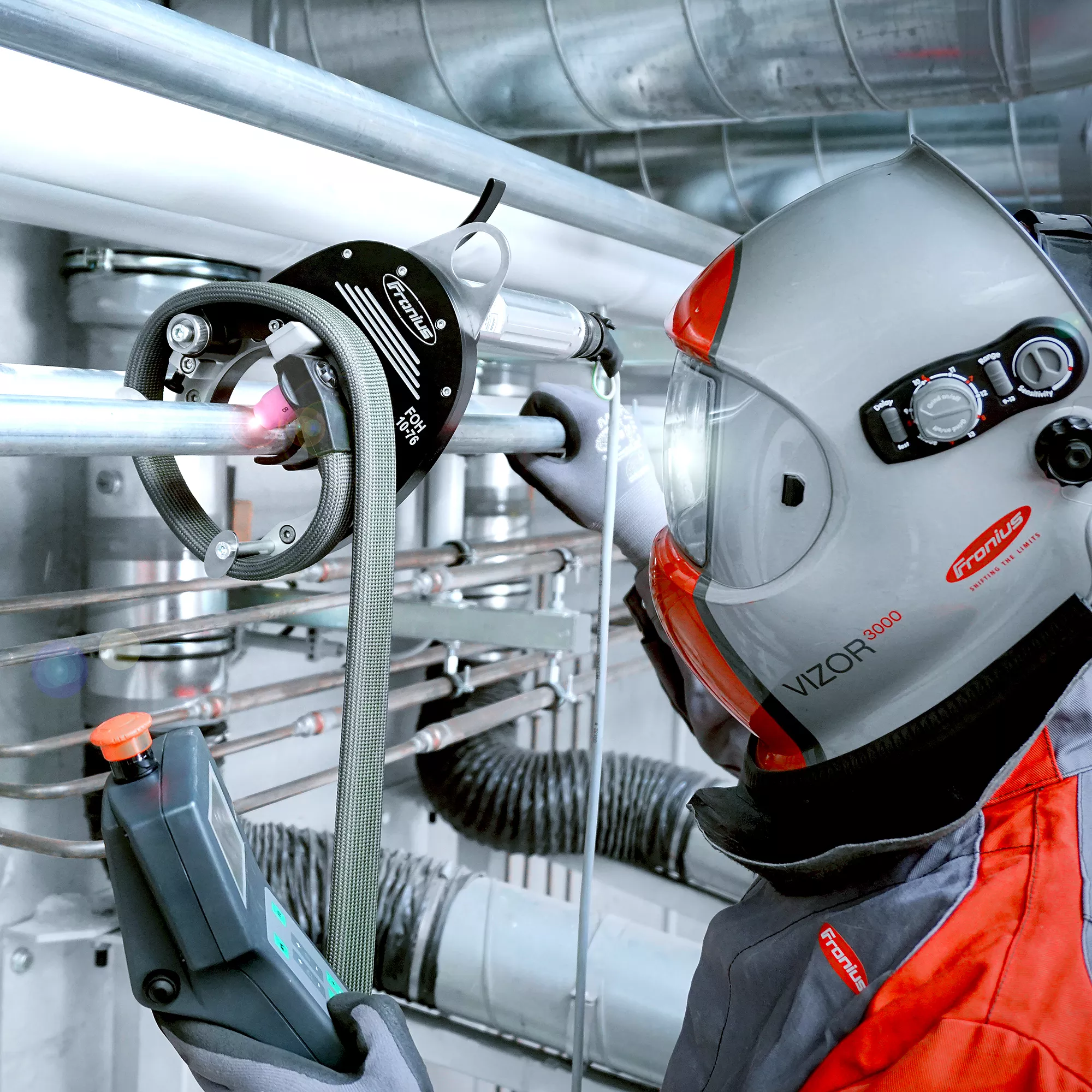

FRC-FPA 3020 REMOTE CONTROL FUNCTIONS.
  • Program selection
  • Start/stop with slope, immediate end of welding
  • Emergency Stop button
  • Manual positioning of the movement units
  • Manual wire feed and retract
  • “On-the-fly” parameter changes during the welding cycle
  • Shielding gas test button and forming gas on/off

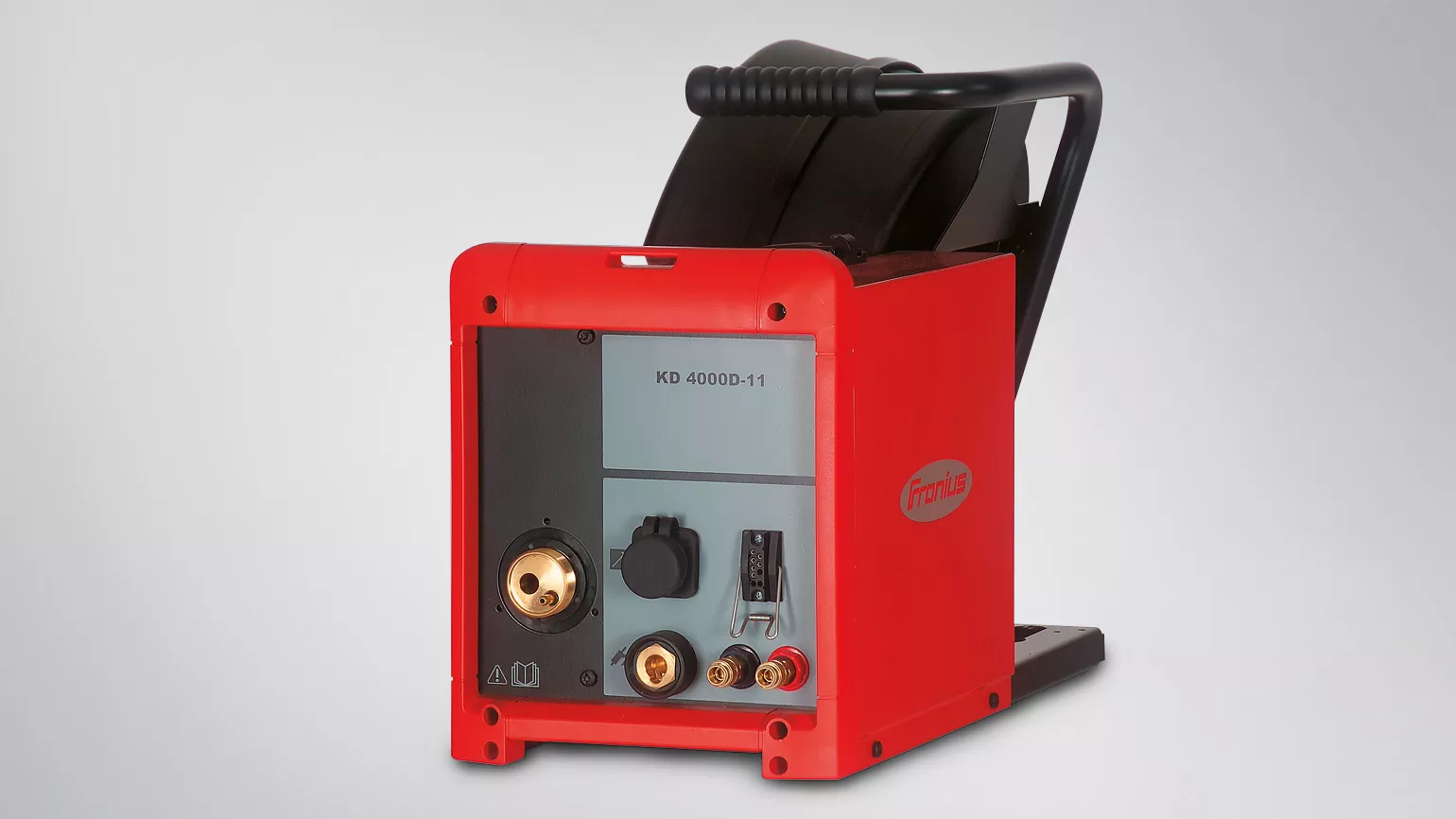

KD 4000 wirefeeder
STANDARD EQUIPMENT.
  • Cold wirefeeder
  • External control of the wire speed via interface
  • Four-roller drive for 0.8 mm wire diameter (trapezoidal groove)
  • Closed wirespool cover for 300 mm/15 kg
  • Hinged/lockable protective cover for motor plate
  • Handle
Pipe welding with open welding head
FOR FOH WELDING HEADS.
  • TTGO F++/ 5 m orbital welding torch (only with FOH 8 - 40)
  • TTWO 2000 F++/ 5 m orbital welding torch
  • Welding torch wearing-part box
  • FCH/FOH 10 m extension hosepack
  • KD 4000 D-11 wirefeeder
  • Two-axis wire adjustment
  • Wirefeed (wire diameters 0.8 - 1.2 mm)
  • Balancer spring return
  • FPA 3020/3030 orbital system controller

FOR KD 4000 WIREFEEDER.
  • Connection cable to system controller, 9 m
  • Two-axis wire adjustment with wirefeed for 0.8 mm wire
